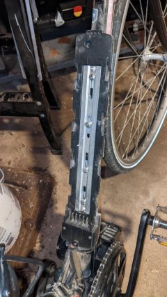

I put 4 bolts in my downtube battery holder. Riv-nut kits are cheap. Use stainless, not aluminum riv-nuts.
Did you drill and tap two extra holes to put the bolts through?

I never go through both sides of tubing with a bolt. Way too easy to crush and weaken the tube. Just drill a hole on one side, insert a riv-nut that matches the diameter bolt you want to use, crimp the riv-nut with its tool and you have a heavy duty anchor point. I lined up four of them for my downtube battery. (Plenty of Youtube how-tos on riv-nuts.)

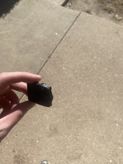

This is the part where I really regret not getting a nicer controller. I started when I noticed smoke coming out of my controller bag after a long ride. Upon further inspection, this was the damage I found:
(Hard to see in the light, but the plastic top of the housing had melted)

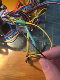

The ebrake line melted by the bad crimp:
Upon bringing my bike into the local makerspace, I was informed that the blue lead had a bad crimp. I cut, re-crimped, and re-fitted the wires, and the bike worked as normal. I also re-soldered the ebrake wire and shrink wrapped it.

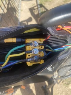

When this happened a second time I was exasperated but not left wondering what to do. I connected all three with nuts and bolts and put heat shrink over them all. Not pictured: heat shrink melting from the final crimp going bad and melting the pictured white connector.
At this point, all three of these leads were swapped to wire nuts. This is the lead setup I had up until my bike was stolen.

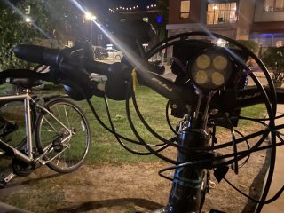

I also installed headlights, brake lights, and turn signals:
I did my best with a ruler, a paint maker, and a drill. Any tips on how to mount it straighter onto the next one?
My final issue before my bike's fateful disappearance (I'm holding out hope like Glen Miller fans did) was it beginning to cog. I looked on here and came to the conclusion that it was a bad lead, or a bad controller, or a bad motor, in order from most to least likely. I opened by controller bag, and this is the site that greeted me:
Note the distinct lack of a wire nut on the blue lead, since the other end wasn't stripped back far enough to hold it in strongly. I burst out laughing after seeing this, because I was so worried I was going to have to replace my controller or motor. Now I get to replace everything!

If you have to use something like wire nuts, I recommend Posi-lock, like these:
While experimenting with different motors and controllers, I used them successfully on phase and battery wires (and much smaller ones for low current/voltage signal wires) for a while (couple of years?) on the SB Cruiser, in our usually-dry desert environment but with occasional flash floods that submerges all that wiring under the trike while riding home for a few minutes at a time).

wire nuts
have no place on an ebike, or any vehicle subject to movement and vibration. Same goes for solid copper conductor wires (except for motor windings.)
Soldering is an art form, as is crimping. Look at some good YT tutorials, learn, and practice. Also helps to use good tools and materials. Avoids similar problems in the future.
