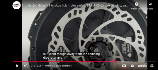

Why does the wire have to go through the axle anyway? It doesn't on Grin's All Axle motor, right?
Technically, it's still going through the axle. It's just that the axle is machined differently on that side and around an inch in diameter with a bigger bearing. So the cable doesn't need to go through the center of the axle. The bearing on the other side is normal sized.

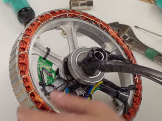

Amusingly, just looking around my garage, there's also a Bionx motor here where the cable doesn't go through a hollow center axle:
You could probably get an old one quite cheaply since no one wants to open them up to run wires out to use an external controller when their Bionx kit breaks otherwise, like the battery dying.
