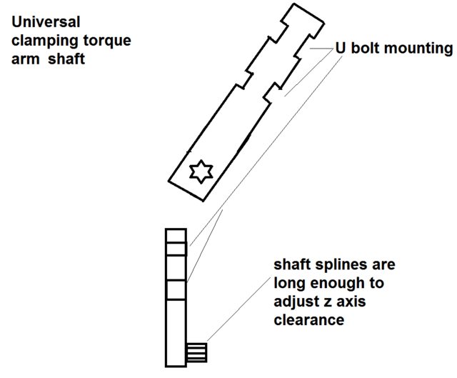

electricwheels.de said:Just worked my way through 11 pages of postings regarding the testing of dropouts and torque arms.
Here in Germany we are just having a similar discussion in our forum, so you can imagine how I lapped up all the info. Great work, Justin.
I've worked on a torque arm design myself, and have come up with a modular design to fit most bikes. Currently only for M12 axles, with M14 axle fit coming up.
What do you folks think of this one:
I make them in front and rear versions, and would be gladly sending some samples over for testing and evaluation if you are interested.
If you like more info, just read through the mounting instructions. There is a 3D explosion drawing in there as well.
http://electricwheels.de/torque%20arm.html
