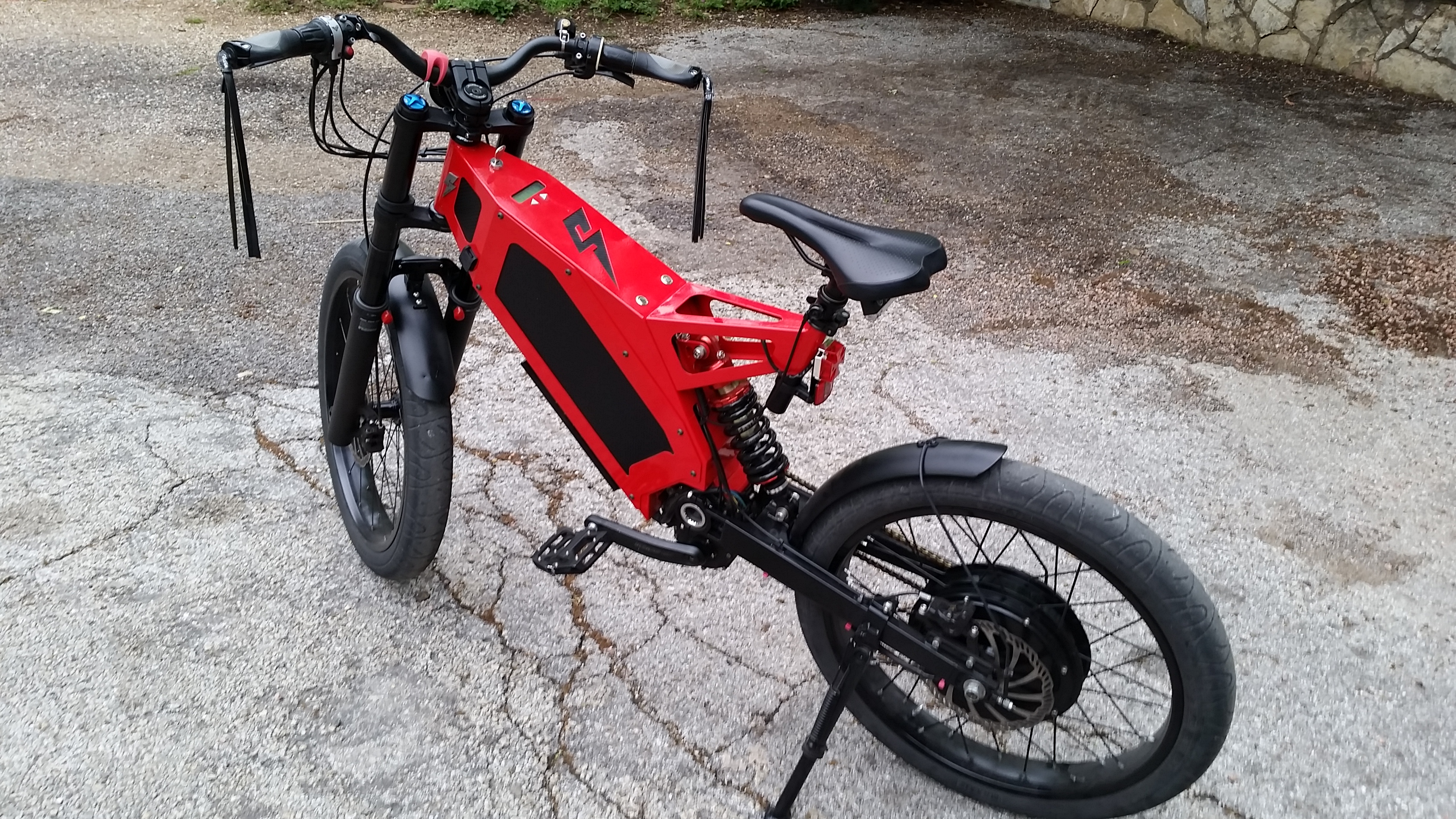

This is a perfect fit. I've decided stay with a 50 amp anderson connector instead of using the 120 amp, because it's too damn big.
I switched the connector back to a stock 50 amp Anderson. What's up the stinky little stock controller wires? Reset the ca to 35ah, and zero cycles. It's on the charger now. Test ride coming soon.
[img
][/img]
[img
][/img]
Quite the battery TV, let us know what your volt sag is when you run it.
Are you fellas using a smart charger that you can adjust percent of charge? aka Luna or Satiator?
Fanks!
I just got back from my first test ride. The air is calm, about 60 degrees. When I took it off the charger, the battery was setting at about 83.5v. The ca is set for 65 amp.
That little ca is hard to see so this is kind of approximant, but this is what I think
Riding pretty aggressively but not all out.
5120w That was a roll on from about 10 mph
68.93 max amp
That seems very similar to my 24ah battery from Electro World when it was new
I think the lowest sag I saw hot off the charger was about 75.5v
I think the Electro World battery had a little more than that, maybe 73 or 74.
Love a lot of parallels
I rode 26.2 miles
used 21.53 ah, who cares still had over 13 luxurious ahs woohoo
got up to 42.9 mph
Avg speed 23.7 through town stopping at all the lights before running them.
This new battery is 20s10p 10 amp Sanyo GA3500 cells
Electro World was 20s7p 15 amp Samsung 30Q cells
I can't help from comparing the Electro World battery to this new one. I don't really notice much difference in performance hot off the charger, but the biggest difference today was near the end of the ride when I was at 21.5 ah, the Electro World 24ah would have been getting pretty sluggish at full throttle, whereas this 35 ah was just feeling a little off, and I still had 13ah. That's huge. Now for the first time since owning this bike I feel like it's what I naively was expecting when I first bought it. Hey this was my first eBike, what was I suppose to know.
