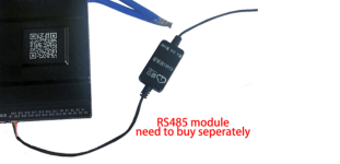

LCD display , CAN chip , RS485 Module , LCD displays don't include in BMS , need to buy separately !
can match 100A 300A 500A 600A 1000A ......and so on relays
