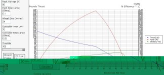

I did received my performance accelerometer/computer this week.
I tested it in my car and then ... with my ebike 8)
I'm talking about this: THE Beltronics Vector FX2
how it work:
It include 2 high precision accelerometer, a timebase (clock) and use some parameter that you enter such as: weight, drivetrain loss, AERODYNAMIC DRAG loss... motor inertia.. etc
Download this presentation video:
http://www.beltronicspro.com/gx2_small.wmv
[youtube]-pC7iuWKic4[/youtube]
[youtube]LFEI73A37ZI[/youtube]
THE USER MANUAL PDF: http://www.beltronics.com/manuals/gx2manualrev1.pdf
MY RESULTS
I tested my integra and got 7.68sec for the 0-60mph wich is close to the real performances
for my ebike at 70V (cell at 2/3 capacity) and 70A current limit, i got:
0-10mph: 0.73sec
0-20mph: 2.65sec
0-30mph: 6.58sec
max speed: 31.9mph.. limited my the missing last battery to reach 100V
HP calculated: 5hp wich correspond to my actual max power(4200W) with this battery configuration and bike weight (108lbs) +me at 145lbs,
that post need to be linked with thisone too: http://endless-sphere.com/forums/viewtopic.php?f=4&t=863&st=0&sk=t&sd=a&hilit=100ft
Soon i'll make a special HIGH POWER low capacity A123 PACK of 100V 4.6Ah that will weight 4.2kg instead of my actual 23AH 75V of 14kg.... i hope that will help!
I want to get 0-40mph under 7sec and 0-30mph under 4sec
