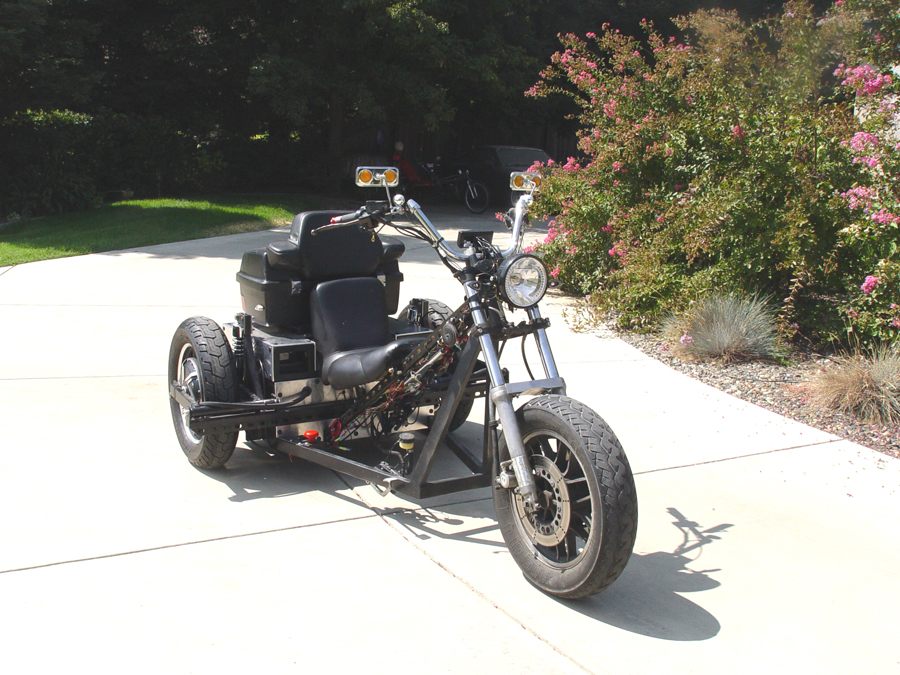

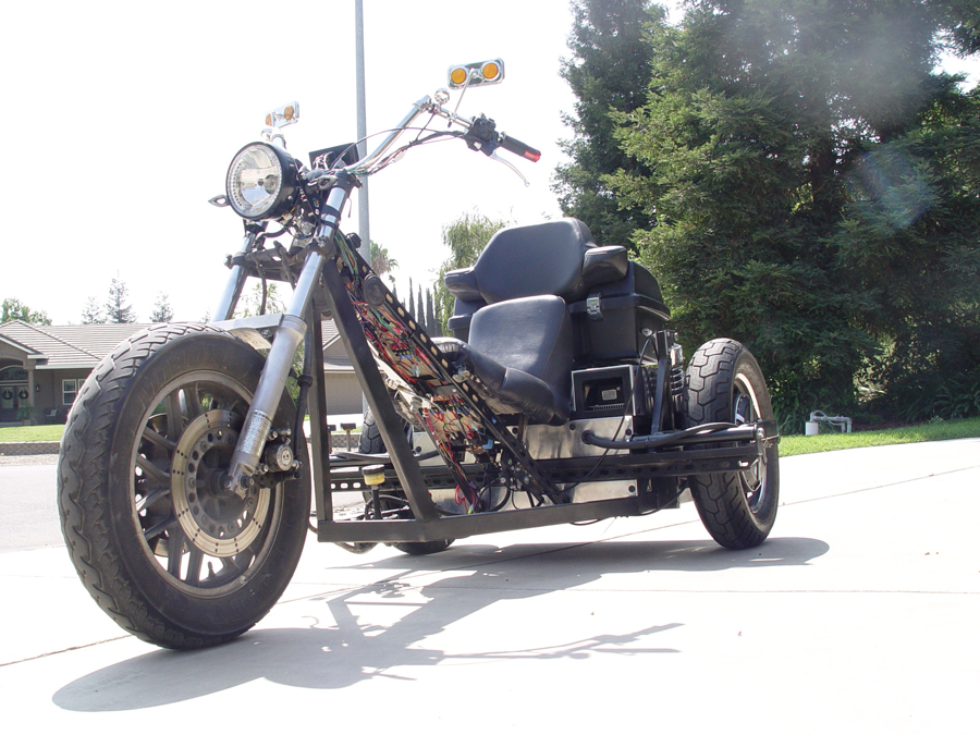

Anyhow - closeups of the interesting build details have been great, but hoping for some shots of the whole trike - quite an inventive and impressive project!

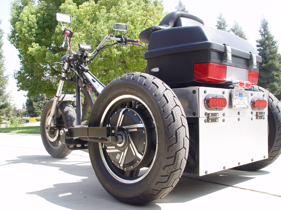

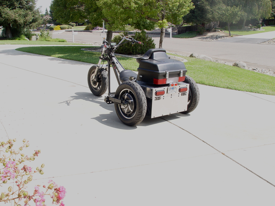

Some photos of the finished trike, running and on the road.

The rearward center of mass now has some actual numbers attached. I put the finished trike on a scale and the weight on the rear wheels is 706 lbs. and the weight on the front wheel is 117 lbs. That means the front springs and shocks are carrying about 266 lbs LESS than they did with the stock Voyager bike (Voyager curb weight is 765 lbs and I'm estimating a 50/50 weight distribution). This also means the rear springs and shocks off the Voyager are carrying 324 lbs MORE than they were on the Voyager...not including a rider or passenger.
Ride wise, the rear feels very good. The rear sits on Progressive coil over shock which are after-market units which came with the donor bike. I currently have them set at their softest spring tension rate so I have room to stiffen the rear up if the extra weight seems to be a problem, which thus far it has not. One thing that may be helping me out is that I am a relatively light weight rider (160 lbs) and the trike is not equipped to carry a passenger. The Voyager, on the other hand, is fully capable of carrying a 250 lbs rider as well as a good sized passenger. So my curb weight on the rear is much higher but my "fully loaded" weight is probably about the same as what the Voyager is expected to carry while maintaining a comfortable ride.
The front end was a totally different story. The stock configuration of the front fork was far too stiff with so much less weight on it. In addition, the original Voyager shocks/springs seemed to be hanging up a bit (like crud had built up inside them) and the ride was far from ideal. Fortunately, the donor bike came with a rebuilt set of fork tubes. The other fortunate thing is that Voyagers came from the factory with "air-ride" adjustable front springs/shocks. So I have now put on the rebuild set of fork tubes and I have replaced all the Voyager air hoses and apparatus (a LOT of extraneous stuff) with a simple 8M x 1 Shrader valve screwed directly into the "fill collar" at the top of the fork. I also replaced the oil in the shocks with 5W and purposely did not completely fill the oil to its normal level. At the moment I am running no air at all in the shocks and they are responding far better than the original units. I still need to get some additional test miles under different road conditions and head for some streets where I know I'll encounter potholes and rough going. But I think the front is now getting close and I have the ability to fine tune from here on out by just adjusting the pressures in the air ride system.
I'll report back more on the suspension and performance as I gather some useful numbers.
