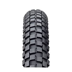

You need these tires man:
Maxxis Holy Rollers. I actually rode my XC bike for a year with these, good enough for most terrain and very smooth on the street.
Yes I was looking at I really like I will be getting them next but I have to wait for mine to wear out first!
