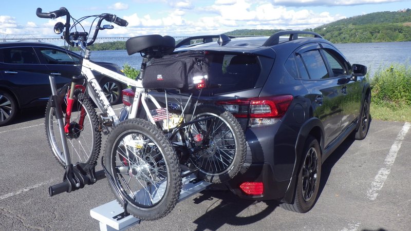

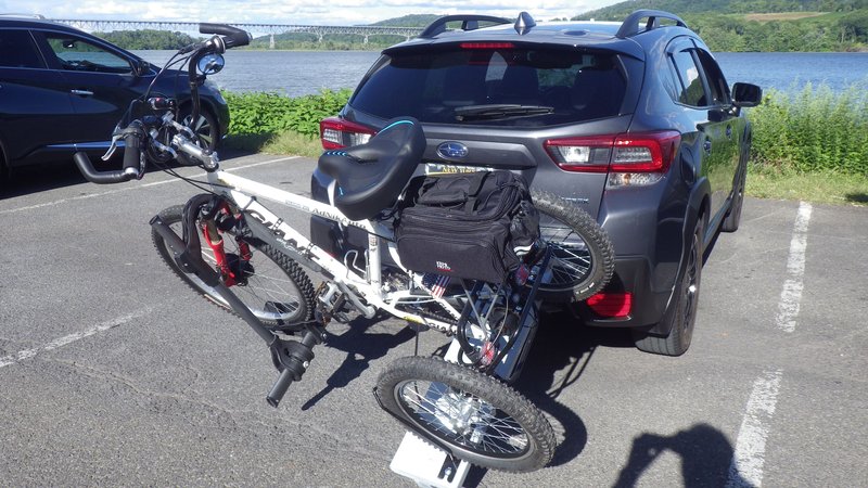

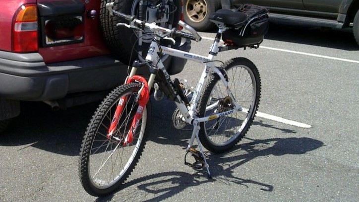

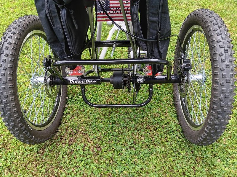

It's started long, long time ago.... as a regular Mountain Bike...
After some time, bicycle was rewarded with some "electrification" - very small and secondary to power of my muscles :D
It was done in times when not so many people was aware and electric bikes were not as popular as todays days...
250 Watt motor was supported at first by 10 Ah battery, than by 20 Ah battery...
No advance controls, just simple On/Off switch - simplicity, simplicity...
Than another idea come to my mind, and Mountain Bicycle started a new exciting life as a ELECTRIC TRICYCLE....
As of today, most likely Trike will receive another electric motor, this time it would be Mid-drive 500 Watt Bafang 48 Volt /or similar/ drive with secondary Battery as well as bigger front sprocket to let me pedal /keep up with electric motor/ with speed above 30 Mph ....
Any advise, good or bad or anything... ???

30mph might be a tad too fast for your trike. And if you install a bbs02 you won't "need" your front motor.
Though I think a capable direct-drive up front would be a great thing. But that brings up a whole other can-of-worms.
Only that I'd guess it's unlikely a trike of that design / layout will be easy to operate safely above around 10-12mph, maybe 15, based on my own experiences--almost any little steering input as you get higher can cause them to flip, as can road problems / condition changes.
If you haven't already, I'd recommend finding a long steep hill to ride down, where you can clearly see your speedometer while riding without looking away from the road, and try it out at various speeds to see how it feels, icnluding performing any of the maneuvers you expect to need to while riding at those speeds normally in whatever conditions (traffic, etc) you have to.
My SB Cruiser trike took some experimentation to reach safe operation at 20mph, and it's a much longer wheelbase, and lower overal COG, different steering, etc.
A previous trike, Delta Tipper...er...Tripper, ;) that used the same rear end I built SBC out of was very unstable and while I could ride it at 20mph, it had to be slowed quite a lot, like to walking speed (or less) for turns, and even then I tipped it over multiple times. If I had less than 26" rear wheels on it it would've been better, but not by much.
Even when I used that trike kit on Crazybike2, about as long as SBC but even lower with various significant design differences, I almost flipped it just going down the street at somewhere less than 15mph. :(

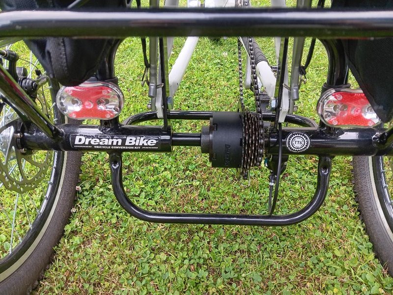

On my system I use two independent rear hubmotors, linked at their throttle inputs so a single Cycle analyst lets me control both with my pedals as if they were a throttle; faster I pedal, faster I go.
My trike kit is heavily modified from original, but it doesnt' work quite like yours--it uses regular wheels with a chain from it's axle to the left one, so it can more easily be done this way.
For your trike kit to be used that way, you'd have to add a subframe to each side with wheel mounts / dropouts, behind / below / etc the present axle-mounted-wheel point, and then add sprockets to the axle ends in place of your existing wheel hubs. then add sprockets on the inboard sides of whatever wheels you choose to use back there and chains between the axle sprockets and the wheel sprockets. Not simple, but not impossible.
The hubmotor itself is simpler than the middrive...but the work to add the hubmotors is much more comlicated than installing the middrive. ;)

Yep, you are right about challenge at higher speed.
As long I'm going straight- /road is going straight/ I can and I did try to "fly" on this bike and correcting the path of the bike by balancing my body instead of correcting the handlebar.
I'm fully aware that sooner or later I may go down in case of wrong way balancing my bike, that's way I did order some knee and elbow protectors... but this feeling is like addiction- going fast make me to go even faster, that's way I need to keep up pedaling no matter how fast I'm going. But current ratio is not sufficient at all...
Thank you for words of caution... (y)
P.S. Just hope that the original aluminum frame will keep up with my 200 lbs and weight of my bike with all the "extras"...

Like your build, really like the two wheel axel setup. never have seen one like that, what is the brand?

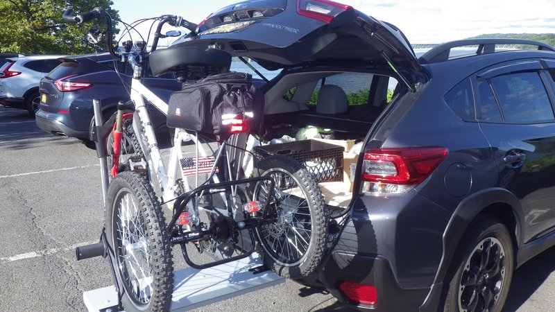

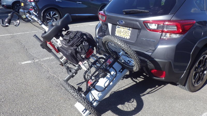

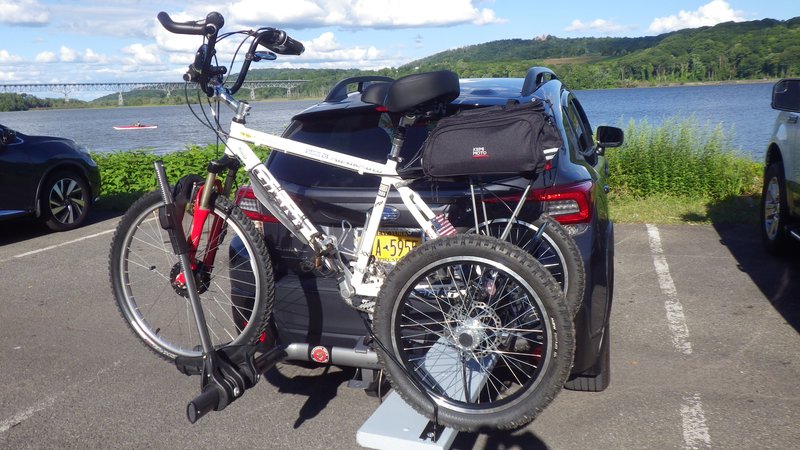

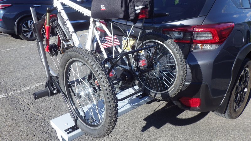

Not really. Tadpole trike is not in my horizon. If I would switch to anything, it would be this:
But it would be a big problem with transportation of this huge, heavy bike... either you need a van, pickup truck with ramp or a trailer... which any of this is not appealing choice to me...
.... beside spending almost 4 grand at once :rolleyes:
So to answer clearly your question: no and no...

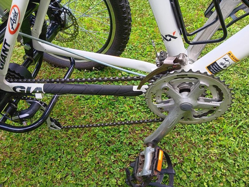

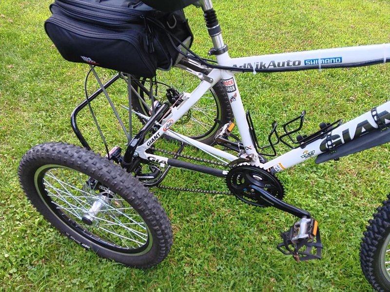

Well, I performed a next step to take me into 30 mph territory!
👍 :D (y)
Upgraded Front Crank:
From 20/32/42 to 28/38/48
Before:
After:

Maybe mount the battery pack/bag behind the rear axle low to the ground to lower the center of gravity and shift it rearwards. Using a shorter steering stem so your body weight also is a little more rearward will improve the stability. But going 30mph on it will surely be very "entertaining" especially if you need to take a curve...
:ROFLMAO: :ROFLMAO: :ROFLMAO:
Already is "entertaining"... 30 mph - only going downhill and relatively "straight"... any bigger curve can take me right to the Earth Orbit...

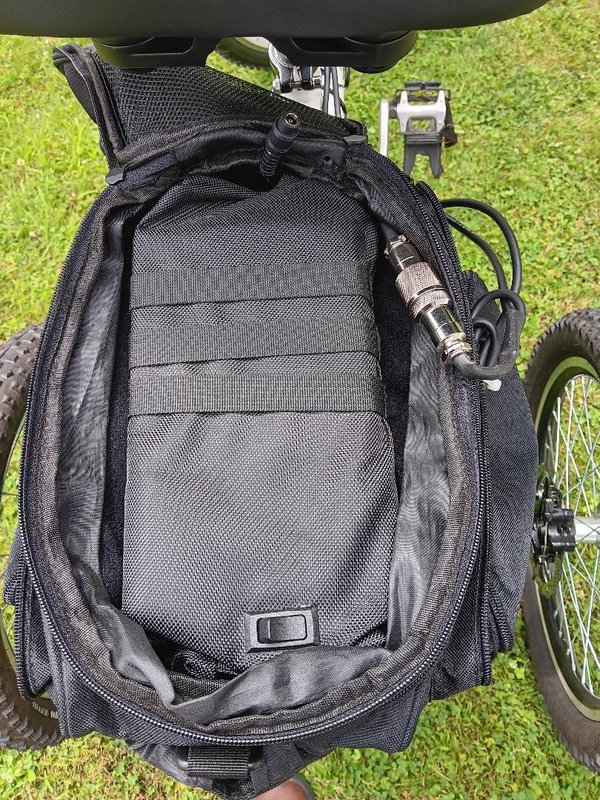

Yep, bike rack look like something... basket not so much, will install when I be 104 age... :bigthumb:
BTW- rack and a bag is a "house" for my bike 20 Ah battery, though... and side panniers are ready for drinks and snacks :cool::p:ROFLMAO: and rain gear ...
