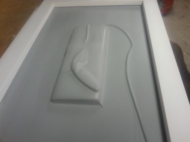

I've been thinking of using kydex for my battery enclosures for a while now! Easy, cheap materials, somewhat self healing and will take a beating to protect batteries (also slides well if scraped). I've not built a vacuum table yet, but do have the nicer press to form with.
Couple questions - what thickness are you using and can you share your forming setup? Also, in the first pic you have a large toggle switch - how was that wired? I wanted to do the same for my on/off switch, but don't know if it will handle the higher voltages and Amps. Planning on the inline XT-90 w/ anti spark instead, but curious how it worked. Also see it's not on the second version, so did it have issues or not work out?

http://endless-sphere.com/forums/viewtopic.php?f=35&t=70553 Here's the link to the Vacuum forming set up. Also, I'd like to mention I dont like kydex. Abs is much easier to work with.
torqueboards said:
That's crazy. I found Kydex to be much easier to work with lol. Although, ABS is significantly cheaper.
I may at some point try it again, but for now I'm sticking to my guns. ABS is better.
good to know. I don't have any ABS, but do have a couple of extra sheets of kydex from old projects. Plus the foam press (not as nice as your vacuum setup). But hopefully it will still work when i finally know how i'm setting up my non-beta board.
Seriously cool and simple setup Psychotiller! ingenious. One thing i saw on some semi-professional vacuum tables (when i was thinking i might want one), was a small string/rope that they ran from the vacuum port to nearly the edge of the form. To help give a channel to pull air and help equalize the vacuum pressure for a clean mold. Let me look to see if i can find a quick pic - usually a coarse cotton rope - maybe 1/4 - 3/8 in i'd guess? here's one they have leading up to a kydex knife sheath:
A big difference i'm seeing is a full sheet vacuum press vs a membrane former that lets you use less ABS/Kydex and smaller pieces than full sheets. I guess that might depend on how frequently you use and how much excess/waste. I bought a small toaster oven (refurb) i think for about $40 that was supposed to be pretty accurate and quick to heat.
