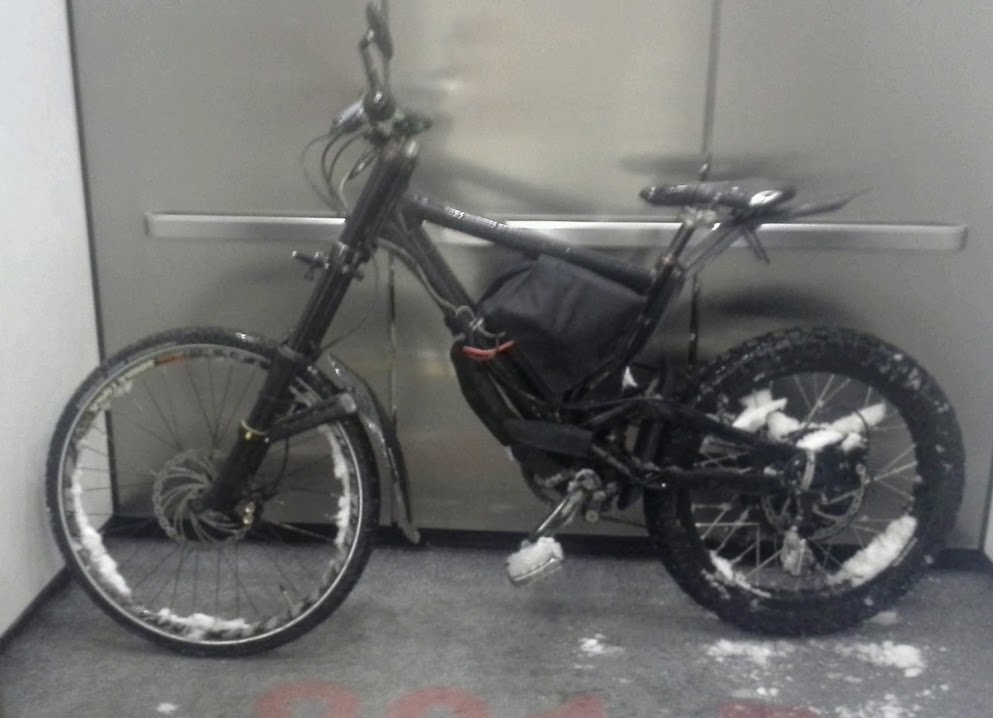

got studded tire on front, then remembered having only front brake would be dangerous, so swapped brake pads - put good front ones on back so i could use only rear brake.
and since bike was so messy, i decided to take use the elevator. :twisted:
ebBbTLYSM-e7vpVIUpWs-8TeWmW8Nm_ZYH_wXjPmcaCe=w993-h718-no
rear fender worked great! and i can easily remove it using zip ties, so it doesn't break off when i flip the bike. :wink:
woulda been really nice to have the front fender tho! got soaked up top. :x
