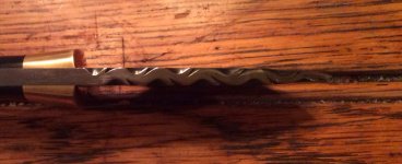

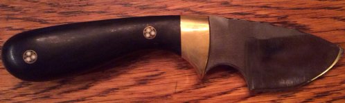

Hey Greg, where did you buy that kydex? How expensive was it? I did a little knife project a while back:

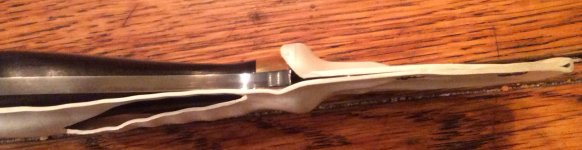

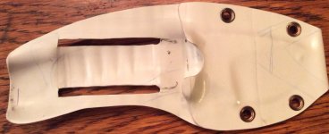

Found kydex too expensive to experiment with at the time so tried some vinyl rain gutter material at Home Depot to play with and made this sheath using standard kydex methods:
Found it pretty easy to work with and effective. Always wanted to try it with kydex though if I could lay hands on some cheap. You might try the vinyl for practice, it's dead cheap. In your case you may want to use a mold of some type to get a good consistent shape. Maybe use a segment of old metal fender as the mold. Most plastics including ABS, which this seems to be similar to, will respond well to edge polishing. Just sand the edges with fine grit sand paper to take out imperfections and then buff it with a polishing wheel loaded with green or white compound. Makes it look factory. Obiwan
