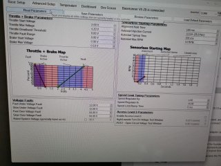

I am trying to setup a grin baserunner v5 Z9
without the Cycle analyst display.
According to the manual I need to connect
1) Main cable B+ pin(red wire) to the On/off pin (orange) via external switch.
I wired that to a throttle with on/off switch and voltage display.
To verify that this step is working I checked with multi meter the 5v pin (brown) and this pin is live with 5v after I turn on the wired switch.
The thumb throttle display shows the battery voltage when I also connect Main cable - ground pin (black) to the black pin of the throttle.
I then connected the main cable - 5v (brown) to the red wire on the throttle and the remaining green wire to the main cable - green wire.
When I connected the baserunner to the desktop software I run the autotune test and the baserunner was able to spin the wheel.
The problem is that when I press the throttle, I can see the voltage change from 1.92 to 4.22 but the wheel isn't spinning.
On the dashboard section of the desktop software I see the brake flag light up when I press the lever and the hall sensors indicators work when I manually spin the wheel but the throttle flag does not lit when I press the throttle...
How do I get the throttle to work?

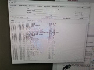

The first photo shows the throttle at rest is 1.9v and the second is while maxing the throttle with voltage at 4.2v

~1V off to ~4V on is normal for an ebike throttle. There's lots of settings for throttle mapping if needed, though.

The throttle voltage I am getting in the developer tab (first 2 Photos) ranges from 1.8 to 4.2 and I noticed that the voltage drops after pressing bellow 1v and later pressing further gets to it's max position of 4.2v

A 1.8 volt d.c signal output from a hall sensored throttle at rest seems high.
I like your work around of increasing the “throttle start voltage“ to 2.0 vdc.
But suspect that you need to increase the “throttle fault range” to that same voltage as to not trip the fault code as seen.
Doesn’t explain the high throttle voltage, but perhaps you can get it to work this way till you address the high voltage issue.
So, it goes *down* to 1v after starting at 1.8v? Then back up from 1v to 4.2v? That's wierd, and sounds like the throttle might have a messed up magnet in it. Some of them have two magnets, in those if one is flipped backwards (the one closest to the sensor when it is "off") you could get this result.

Changed throttle and this one goes from 0.88V at rest to 4.21V with max pressure applied. Cleared the throttle and brake fault range back to default values 1.2V - 3.5V for throttle and 0.85V to 0.2V. No more faults showing in dashboard after this.

Similar to another users post and what the manuals were suggesting I wired the ebrake return signal to the mains cable throttle signal and then jumped the throttle to the ebrake pin on the BR mains cable. In the Phaserunner suite the ebrake pin is labeled as 'Throttle and Brake voltage' under the Developer tab (addr 271).
Now that the brake and throttle are linked the Advanced setup tab -> throttle+ brake parameters come into force as expected
If you connect those two, then you can't use a separate brake control.
The usual reason for connecting brake and throttle input wires together is if you are using a Cycle Analyst, as it turns your throttle into the variable brake control when you engage an ebrake switch that's wired to the CA as well as your throttle. Since you're running headless, this is not an option.
So for your use case, with those tied together, you have to use a throttle that can output a voltage "below" it's off voltage to provide brake control voltage. There are some that are like the Vectrix throttle which has a center detent for "off", and rotating it backwards increases braking, and rotating it forwards increase acceleration, I think Wuxing makes one, but it will have to replace your existing throttle.
Or you can build an arduino/etc MCU-based unit that does what the CA does.

Field weakening switched off, thank you for the tip. I can always come back to it if I need higher speeds to test.
Knowing its a non-regen motor, the throttle with variable voltage braking is probably an overkill in non-regen bikes? Is it not a case of on/off ebrake for all but regen capable setups?

I connected the to multi meter and that showed me the voltage moved from mV to volts but the multi meter updates too slow to register the fast changes. What I can confirm is that the voltage changed as the wheel is spinning and that "wheel speed sensor" lights up in the dashboard.
It won't be fast changes if you are manually spinning the wheel slowly to see how it changes...because you just spin it slower so you can see them. ;)
If you're trying to see pulses while the *motor* is spinning the wheel...that could be difficult.

<snip> Knowing its a non-regen motor, the throttle with variable voltage braking is probably an overkill in non-regen bikes? Is it not a case of on/off ebrake for all but regen capable setups?
Since the motor can't do regen, there's no reason at present to add any form of motor braking control. You can use the on/off switch in your existing levers if you like, to provide a motor-turn-off signal if you like, but as long as you stop pedalling when you brake (for PAS/torque control) or let off the throttle, you don't need that either.
