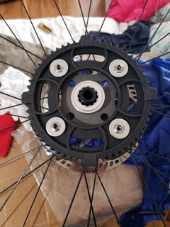

Cyc has 53, 63, 72 sizes. If you have 7kw peak, you are fine with 45mph lowest and 51 tallest, or even 60 for cruising at 40-60% of max rpm. The difference between these 3 cogs is quite small so it would make sense to have 53 front and 53/72 rear. Also, the less gears, the straighter the chainline.
You don't quite need a cassette, just an alu adapter from simano freehub to 104, make it thick, at least 5mm if alu and the 10.5mm chainring bolts. So you can just stick the two cogs on each side of the adaptor. Use plenty of locktite though or your bolts will go flying. :lol: I actually have an adapter like that, got it from a machinist on ebay.
Obviously you can't use a derailleur for this though unless you widen the cage and replace the cogs. You will need a tensioner roller, hooked up to the derailleur hanger.
Belt drive you will have to decide soon, because it is a different motor and rear triangle/adapter setup. The main benefit is it allows you to pedal while the motor is running at basically any speed. I don't really miss it, but it would certainly look cool, and almost silent.

..You don't quite need a cassette, just an alu adapter from simano freehub to 104, make it thick, at least 5mm if alu and the 10.5mm chainring bolts. So you can just stick the two cogs on each side of the adaptor. Use plenty of locktite though or your bolts will go flying. :lol: I actually have an adapter like that, got it from a machinist on ebay...
Get it from this guy? https://www.ebay.com/itm/352841004447
I got the same thing then got it anodized:
