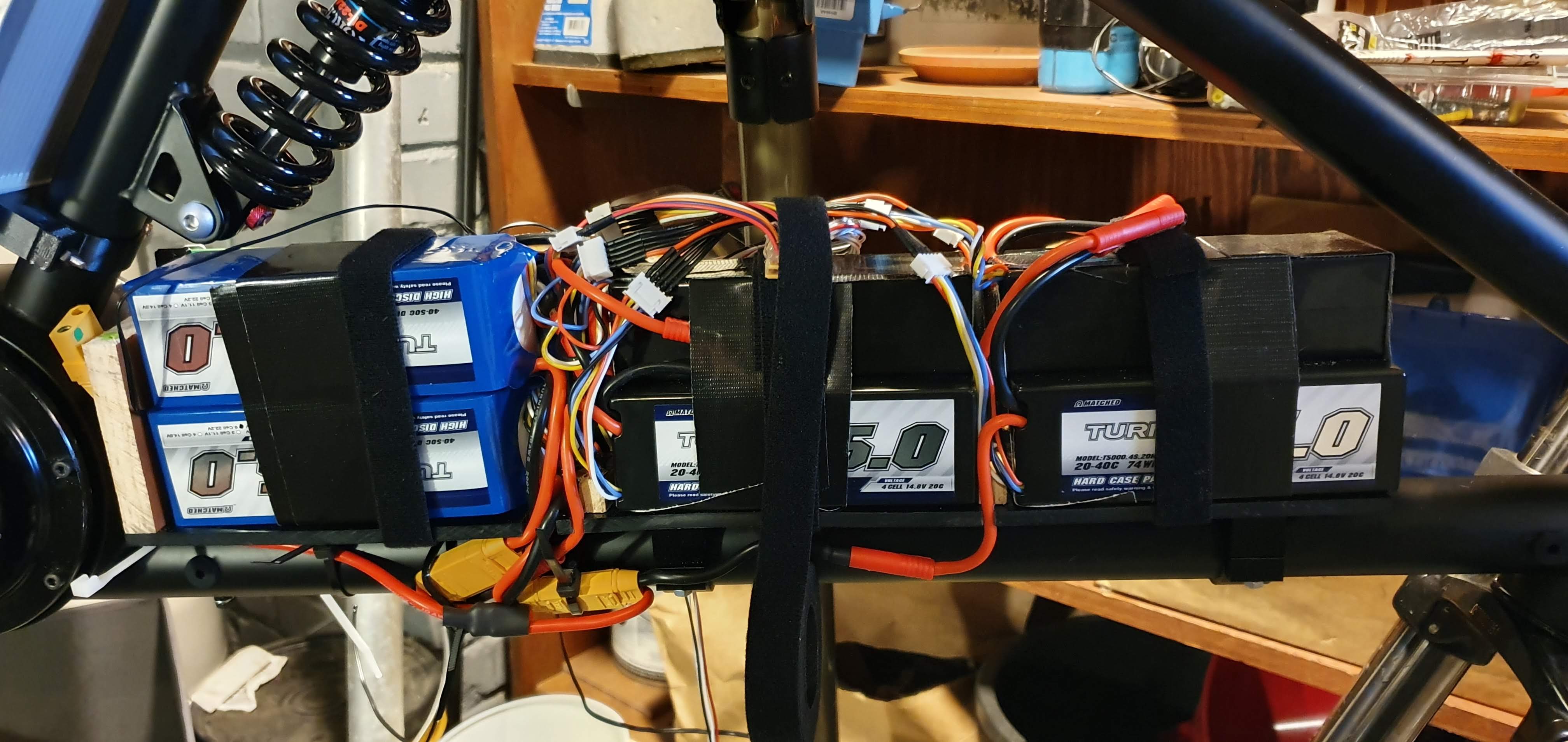

After a 2 month shipping delay caused by USPS losing my first kit, I finally received my Elite frame and coaxial motor at the end of October, built the bike at the beginning of November and started riding it 2 weeks ago. I've put about 50 miles on it and its been quite fun with no major issues. Thanks again to everyone who provided their experience in this thread, it was extremely helpful in getting things built up. Here's how it looks now:
I made the battery box from ABS sheets held together with 3D printed end caps and right angle brackets. The battery box is bolted and epoxied together on all sides except one, which is sealed with foam tape and can be pulled off by removing a few machine screws. Here's the inside of the box:
And here's the batteries before installation of the box:
I went with 18S 10AH of HobbyKing LiPo, which is connected to a JBD BMS that you can't see because it's behind the two blue bricks. The batteries are mounted on a 1/4" ABS plate which is held to the down tube by 2 of the M5 threaded holes in the frame, and 2 3D printed clamps. So far the battery mounting seems sturdy but I haven't hit any bumps bigger than a pothole.
In the first couple weeks of riding my biggest gripe was that the throttle was way too sensitive. With the stock throttle from the kit, there was a huge dead zone and then a very short turn from 0-35mph. To reduce the sensitivity I hooked up a microcontroller between the twist throttle and controller throttle input that reads one of the motor hall sensors to measure the RPM and create a sort of torque-control throttle.
For the drivetrain I went with an Aliexpress 11-50t rear cassette and 32t 104 BCD front chainring, per Tommmm's advice. At first I only used 1st gear, because this gives a 35mph top speed which is plenty for my use. The chainline is pretty curvy in 1st gear even with the motor pushed in far enough that the chain is less than 10mm from the tire, and yesterday I noticed the narrow teeth on my 32t chainring have already been worn down into knives. So clearly I need to shift out of 1st gear as soon as I can, and probably switch to a steel front chainring to give it a fighting chance. I would try using the stock 22t chainring but it sounds like the build quality on that is pretty poor.

Tire clearance: Remove the 1 or 2 smallest cogs on the cassette. Now you can move the big cogs further out. If you don't have cassette spacers you can use the cogs as spacers too, but it might not be flush.
Front chainring: forget having 2 cogs front. The small one is too small, plus it is an integral part of the motor itself and very expensive to replace. Use it as a carrier for the 32t, put it as close to the 22t as possible while being able to tighten it. Use as many washers as you need. You might need to buy a set of extra long chainring bolts from ebay or ali. You can't put it ontop of the 22t(because of the teeth) but you can put it very close. So after the pedal bit it will be going back inside towards the motor.
Now you have a great chainline and can position back the motor to its correct spot.
Careful tightening the motor clamp as if it is too lose, the motor will turn inside the clamp and rip your cables. Too tight and you will destroy the clamp. The edges of the camps should look like this / \ not touching, but bent.
I have 2000km in the same cheap shiit $7 32t, and it is completely fine. The 22t will run you high as $80 because it is a welded made to order part. Forget using it as a chainring. Chainline is everything.
Btw 200mm*57mm is the biggest rear shock that will fit, or in theory a 205mm*65mm trunnion mount one. But those are rare and expensive. 10mm longer shock/travel translates to 20mm more ride height/travel.
If you want to use the internal cable routing, it is better to file/sand the inside of the hole because they will bite into your cables hard.
For the controller, the settings that worked for me to tame the throttle: Fast start 6 on street 8 offroad. Soft start off, adjust accelerator curve on.
If you are still not happy, you can buy a domino ebike throttle. Best in the game and there is a guide here how to put resistors on the cables to get it working.
If your bike starts to sit funny with the rear suspension bushes, it means they are probably destroyed because they are plastic, you can replace them with igus plastic bushings or copper coated bushings. Internal diameter is 8mm outer 10mm, better to buy ones with collars on one end. Length doesn't matter because the holes are not all the same so you will be filing some of them anyway.
