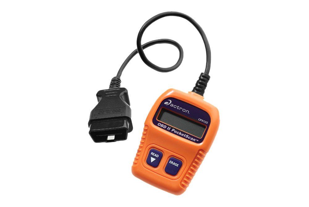

I bought a Actron OBD II PocketScan code reader cp9125.
Unfortunately, this car only yield a blank screen. It gives no codes. (The code reader does work when I hook it up to my own car, a different car from this one.)
Having never used one before, I'm impressed with this code reader. Although it isn't currently useful for this situation, I can see how it could be. I recommend everybody get one.
