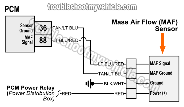

I was able to find a few places
How to Test the Ford Mass Air Flow (MAF) Sensor, test 4
Ford MAF Sensor Testing, Ground & Signal, youtube vid
that seemingly explained how to test a Mass Air Flow MAF sensor, even a Ford one, but I didn't find instructions on my specific one
According to troubleshootmyvehicle, for a 1999 Ford 4.6L (mine is a 2005 4.6L),
Tan/light blue - MAF ground (labeled MAFRT, return, apparently, on wire diagram)
Light blue/red - MAF signal (labeled MAF on wire diagram)
I conducted the tests insofar as I understood them.
The hot red test good.
The BL/WT is a good ground.
The TN/LBlu is also a good ground as it should be. There are 2 grounds here.
Now the LB/RD, labeled MAF signal (and just MAF on the wire diagram) is 1.2 V at idle and when the engine is revved up (don't have RPM meter), I get maybe 2.6 V. This an increase alright, and the increase is repeatable, but is that enough? The last vid linked to above says the small V increase is normal. But I had the impression that the voltage increase should be more. IDK.
I'm beginning to think I need to look elsewhere for the source of the problem. I suppose the fuel rail pressure temperature sensor is next. Suggestions?

Anyway, after more-thoroughly reading the test instructions I had already found, I'm convinced the 1 volt or so spread from idle to revved up is adequate. My results seem close enough to Ford MAF testing vid recommendations. However, I'm not altogether sure. This pdf Successful MAF diagnosis says a simple test often gives a passing grade to a truly bad MAF, and the article offers deep discussion of the subject.
I'm now looking into the Fuel Rail Pressure Temperature Sensor.
Seem like the MAF sensor is working OK. The hot wire kind can get gunk on them or the wire can break, that's about it. The other code pertained to something like
