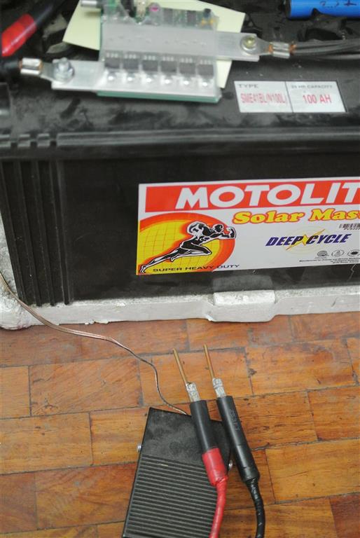

Geekineer said:Hi....its a home brew but very similar to J P with 1407 driver chip and 6 parallel 1324 fets. Twice blew F E T closest to driver. All pins shorted and drain lead fused. Need to replace all six I guess and add external avalanche diode. Trying to understand root cause of failure...avalanche or over limit forward current/time.
pguk said:I have drain side current coming in from left hand side (of a single row of 6 FETs), and going out of the source side from right hand side. I use a single gate resistor to equalise gate current. One thing I didn't do was to match my batch of 25 FETs into groups of close turn on times. Perhaps the one which failed had an earlier turn on time than the others - it was the 2nd one in from the right hand side.
riba2233 said:pguk said:I have drain side current coming in from left hand side (of a single row of 6 FETs), and going out of the source side from right hand side. I use a single gate resistor to equalise gate current. One thing I didn't do was to match my batch of 25 FETs into groups of close turn on times. Perhaps the one which failed had an earlier turn on time than the others - it was the 2nd one in from the right hand side.
There's the problem. Also you don't have to match fets.

pguk said:Not according to Texaspyro on here. He has built an amazing welder and is something of a welding/coding wizz, and has posted some working principles which I wanted to take full advantage of. https://endless-sphere.com/forums/viewtopic.php?f=2&t=2633&start=575.
"In order to keep the currents balanced through paralleled mosfets, you need to drive them with the same source... no independent drivers, no independent gate resistors. It also helps to match the mosfet gate threshold voltages. For all the gory details see: http://www.irf.com/technical-info/appnotes/para.pdf . If your eyes gloss over easily... don't bother... it's rather heavy going."
Myself - of course I didn't bother with the gory details, but I took the advice from a guy who built a more powerful system than we are working with here![]()
