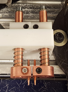

Traces were milled with cnc machine.
Not pictured is a Teensy board that controls the show. I send it a request for via serial port for X energy on the caps. The Teensy charges or discharges caps to a voltage corresponding to E=1/2 * C * V^2. Pulse timing is also set via serial port. There's a weld pedal input pin, but that's also controllable via serial port.
I wouldn't mind open sourcing it once it's a bit more polished. I wonder how many people actually want to build a welder themselves with caps that have this same terminal spacing and threads.
I also made a spring loaded weld head. This part might be of more interest to the community.

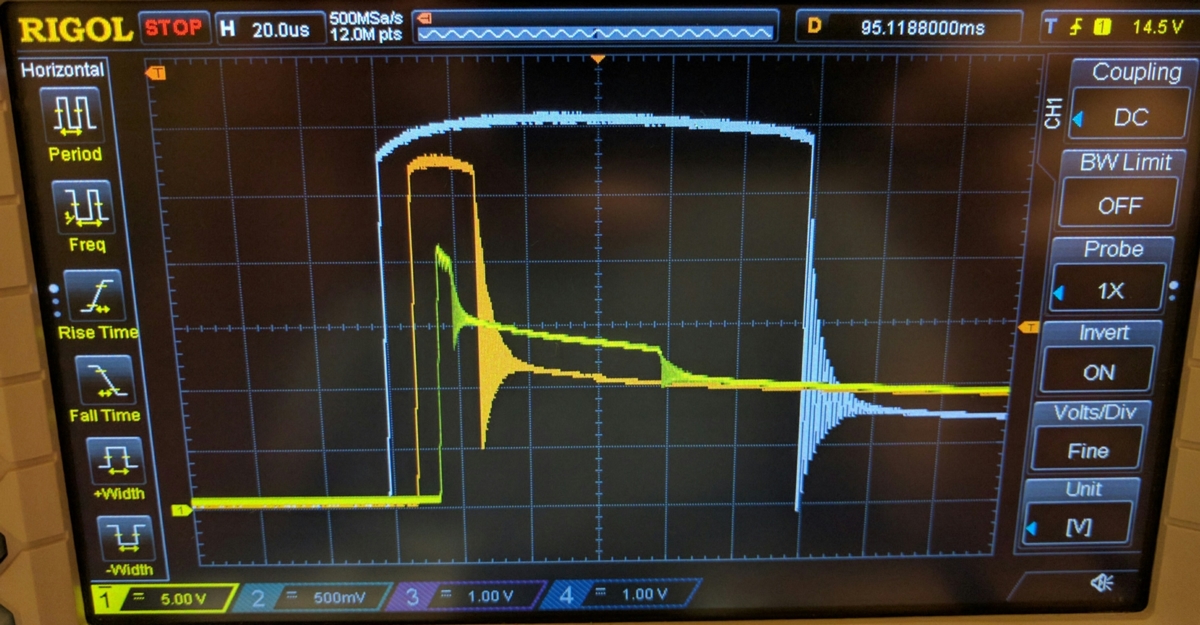

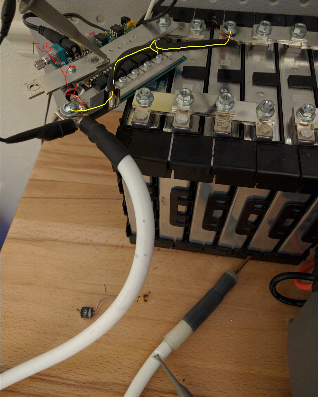

okashira said:
Finally. Did a before and after fully quantifying the effect of the flyback diode. Further, Added a TVS diode and I was able to completely prevent avalanche!
SOURCE-DRAIN VOLTAGE @ MOSFET TURN OFF
All are done at welding current of about 2,500 amps.
1.) WHITE - no diode - 110 microseconds of avalanche, peak voltage of 30.5V across FET's
2.) ORANGE - flyback diode added - 20 microseconds of avalanche, peak voltage of 29V across FET's
3.) YELLOW - TVS diode added - zero avalanche - peak voltage of ~21V
One way I really found out that the flyback is doing most of the work. I tried the TVS diode alone, and it immediatly blew the leg of the TVS diode on the first pulse. It's fine with the flyback there.
TEST SETUP
I'm confused here, is there currently something better than using that huge schottky diode that you were using originally? That is what I'm using right now.

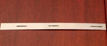

My findings on electrodes sticking may not apply to too many configurations out there but I thought I post them just in case it helps someone out of new things to try to resolve it.
I did not have much sticking problem with 0.15 mm pure nickel but when I went to 0.20 (also pure nickel) all hell broke loose; it was sticking so bad it looked like it was designed to do so.
Someone on the board mentioned cutting a slit on the nickel and I tried that. It really worked in my case and I am finishing a jig with an abrasive cutting wheel from Dremel, 0.025 inch thick, that will allow me to quickly cut just the perfect size slit on the nickel strip wherever I need it.
I will post some pictures in a day or two.

I think the craters you are talking about is when you dont have a solid connection under the nickeltab. Like when you are slightly beside the positive terminal of the cell. I had the same craters, but didnt really weld after that occation, to see if I actually was "missing" the positive terminal. Someone in this thread had this idea.
Here are the pics of the jig I made to allow me to quickly (literately, about 2 seconds) and consistently cut a slit on the nickel strip.
I know it looks over the top but I had this wonderful phenolic material and a Weecher rotary tool with a straight wand that is great for holding it in a similar fashion as a chop saw.
I know they sell some nickel already slitted but I don't like its width and thickness and at least the one I bought is not pure nickel.
The mandrel is mounted in a swinging support with two springs to push it up and allow the positioning of the strip in the slot that is exactly the width of the nickel. Then a quick push down and a slit is form, allowing for a weld with less sticking electrodes.
