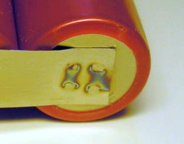

Do you think this will be able to do 0.2mm thick nickel strips?
I have been welding whatever batterysupports.com sells. I think its 0.15. Their website seems to be down.
OK OK My bad, reading below the gentleman is not in England, but in Belgium.
Sorry.
Weld pulse time of 100ms seems way too long and would transfer too much heat to the cells me thinks. I don't get the rainbow of colors from heat shown in this pic even welding .3 Nickel with the JP Welder.
I bought one of these bad-boys Arduino timers and they work really well as far as the timing is concerned.
Unfortunately, there is a lot more to a good weld than just an accurate and flexible timer.
I had previously bought one of the Chinese, under powered Sunkko 788 units and it lasted enough for one battery pack. Then it broke.
So, I purchased the timer from the guy in Belgium (avdweb.nl) and one of these spot welders (the 240 volts):
http://www.harborfreight.com/240-volt-spot-welder-61206.html
And replaced the guts of the Sunkko with the timer and the transformer from the HF spot welder.
Plenty of power (had to replace the secondary windings on the transformer, as the 1.8 volts from the single turn from the factory was not enough) and I can weld very well but only up to 0.15mm pure nickel. (4 to 5 ms is all it takes)
But if I try 0.2mm, I get sticking electrodes no matter what I use. I have tried multiple alloys made for spot welding and different copper alloys, but they stick more or less the same. Even tried the Sunstone Engineering recommended part for battery spot welding and got no relief. The problem with sticking electrodes is a bit better when using steel covered with nickel but I don't want to use that material.

I always seemed to get some sticking when it was making good welds. Rocking the tip or twisting it would break it loose easily. With handheld electrodes, this is easy in practice. I'm not aware of a good way to completely prevent sticking. It seemed if the contact was a bit poor, sticking was more likely. Cleaning the nickel first seemed to help.
There could be a lot of reasons for sticking electrodes. Sticking means the electrode material is molten and has become part of the weld itself, which it isnt supposed to.
Main reasons:
- too little weld pressue
- uneven weld pressure
- contaminated electrodes
- contaminated material
- wrong/molten eletrode material (plain copper is just not up to the job)
- wrong current/power settings
- wrong timer settings, upslope, downslope, hold and squeeze settings
You have to try different settings starting from the bottom-up.
Paul

I noticed with more pressure, it had less tendency to stick and keeping things clean helped.
