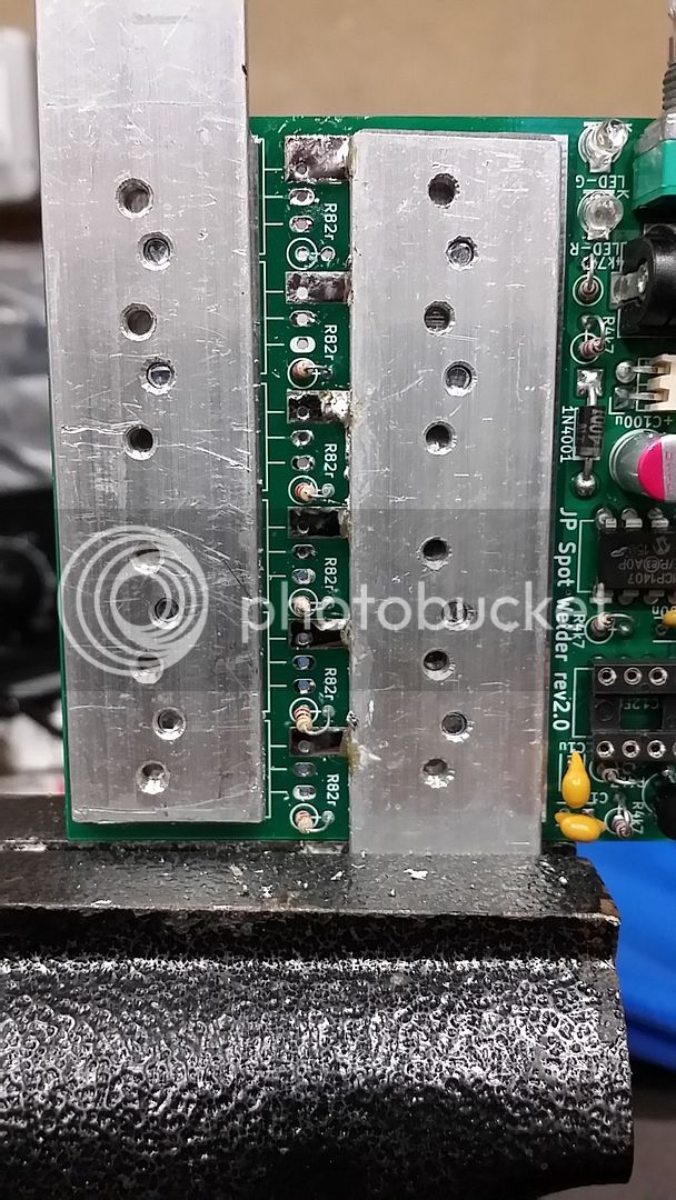

Craigh85 said:
Finally got round to hooking up my spot welder today. Managed around 200 great welds using a 12v car battery, then for some rrason unknown to me a blue flash came from the welder. Now I'm getting nothing. Green light still shows when I press pedal but that's all. How do I go about fault finding?. I've no idea what went wrong.
Doh. Look at the fets closely, take a pic.
Can you describe the blue flash?
Was it light, smoke? Anything smell burnt?
Do you get any voltage between the probes?
Right, see if there is voltage on the probes before the foot pedal is activated. If the FETs blow, they generally short so you'd see 12v on the probes all the time.
Lucky the JP board is very easy to troubleshoot and fix.
Would the blowing fets have been less of a problem if it was a 8 or 12 fet board instead of 6?
I'm thinking it should have been built with more fets.

I replaced all my fets, and they came out easily by heating all 3 prongs on the back with some added solder and pulling the fet right out. A solder sucker easily takes care of the solder.
Unfortunately my welder still doesn't work.
Green light lights up. But there seems to be no voltage at the probes and nothing welds.
I jumped 5 volts into the MCP 1407 from the PIC +5 volts and the gates are not opening but the green light is constant. I've done this before when I blew my PIC chip and this opened the gates.
I checked continuity between MCP 1407 and gate resistors and all seems fine. Resistances all seem fine.
The solder between the Drain and Source pins are very close (almost touching) but i read 2 million OHMS between the two prongs so I assume it isn't making continuity.
Should I replace the MCP 1407? Anyway to jump voltage to the gates to see if the problem is in the MCP 1407?
Thanks for any advice on what to troubleshoot next.
The 2M ohm reading is probably just from solder flux residue. Not a worry.
Does the red light blink when you hit the foot pedal?
If not, you could try measuring on the input of the gate driver chip to see if there is a pulse coming from the PIC.
