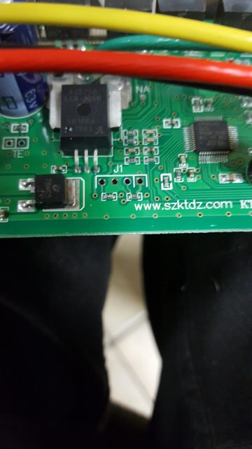

I have read the instructions, but I don´t understand where to solder the wires for the st link. I have an 18 fet controller. Is it on J1?
It seems like there are a few users of the 18 fet controllers here, so there should be some people that knows I think. The second hole from the left is ground, but I don´t see any obvious 5v connection. At least it is not connected to the other 5v that exit the controller to pas, throttle etc.
If this is not theright spot, what markings should I look for?
Edit, I hooked it up and measured. There is 5v at the 4th hole from the left, so I guess it is the same as in the instructions. Just that it is wired the other way round.
