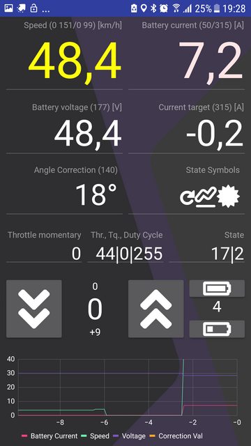

I programmed my controller today, but there are some problems.
Before I changed fw I mesured consumption, it used about 1,5A at full speed with the wheel in the air. It was working fine.
After programming with the wheel in the air I can not get a steady rotation. I get power for maby half a second, then the wheel rotates freely for maby 2 seconds. Then power for maby half a second again.
On the ground it is noisy and draws many amps. I don´t have a bluetooth module yet, so I cant use the app. But I tried the diagnosis on the computor, but I can´t make much sense of it. I get some numbers, but not any foult messages or something like that.
Here are the settings, if you can see something compleatly wrong:
I have an 18fet controller and a DD hub. I think it is a copy of a 9C 2706
Rasing the correction angle seems to help, I changed from 127 to 168 then to 172. It has improved a lot. And setting all speed limits to 99, now i can get stable acceleration. But a bit sluggish.
But the only ting working on the lcd3 is battery voltage, no speed, no symbols for braking, no battery indicator.
It also seems like changing assist level has no effect. I havent tested on the road, but it works on assist 0 with the wheel in the air.
And it has a delay when I release the trottle before it stops pulling.
This should mean that the halls are in the right order I think?
Here I have some correction angle, I think I should get that down to 0?
I have tried to adjust the Motor specific angle and the correction at angle, but it dos´nt seem to help much. I don´t find much information about them in the instructions at C#ROME-B
Here are some more values, and does these throttle values mean that I should adjust the min throttle to almost 0 and the max to almost 249?
But the throttle is not very important now, I can probably figure that out later. The main question is how do I get the motor to run smooth?
keep the correction (at) angle at 127. Play around with the motor specific angle. Sorry the function of correction (at) angle is not dokumented in the wiki yet.
