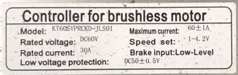

bj97301 said:
I have a kt controller(https://a.aliexpress.com/_dUn7d5Y) and am wondering if I should use this firmware or the tsdz one because this one is no longer maintained and they use the same micro processors as stated in the wikis.
Hello, you have a beautiful controller.
Just in case, do you know the meaning of the product code ?
I understand it's 72 volt sinewave (SVPR), but then what is the meaning of final CKD-JLS03 ?
That is puzzling to me... :confused:
Thank you. I actually have the 60v version. Not sure about the model numbers. Attached are pics of mine. What firmware do you use?
Also, I should mention that this controller arrived in a non working condition. I am hoping to get it working with the os firmware. The pcb looks good so I am hoping it’s a firmware issue.

I see you have sinewave 60 volt, not 72 volt.
But the code is similar, ends with 1 and not 3
I can't figure out what is the meaning of the last part.
