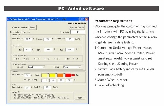

Hey guys, I'm about to buy one of these bike kits, it doesn't have a display wire at all so I'm not sure if it'd be compatible with this firmware since I see you need to solder stuff to it to get it to work with the app over bluetooth (I have spare modules laying around).. Is there any way to add a display connector for bluetooth? What controller do you think this might come with? Thanks a bunch, still new to all of this.
https://www.ebay.com/itm/26-1500W-Rear-Wheel-48V-Electric-Bicycle-Bike-Motor-Conversion-Kit-Hub-Cycling/322269304808
