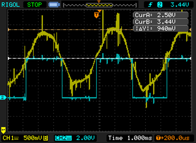

First, the signal wave on ACS712 can't be measured with a multimeter. The ~2.5V seems ok because should be the average value of the signal. I would say ACS712 is working ok.
The signal on ACS712 is this one on yellow line:
https://opensourceebikefirmware.bitbucket.io/development/Datasheets_and_application_notes--Endless-sphere.com_forum_messages--2017.10.23_-_FOC_and_no_FOC_comparison.html
I could not understand if it is working well or not and if so, what is the final code -- can you please explain? maybe step by step and numbering each step? I really want to understand and learn with your problem to see if I can improve the firmware.

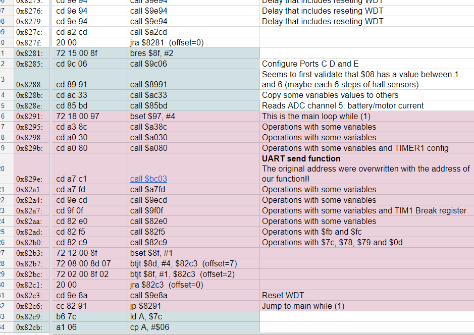

casainho said:
We found the RAM registers that hold the torque sensor value and cadence :) The other developer, also a German guy, had to make code to print to UART in real time RAM and so he could identify the variables for cadence...!!
So it is not the original Tongsheng firmware but modified on assembler level!?

stancecoke said:
Yes!! All started here, less than 3 weeks ago :)

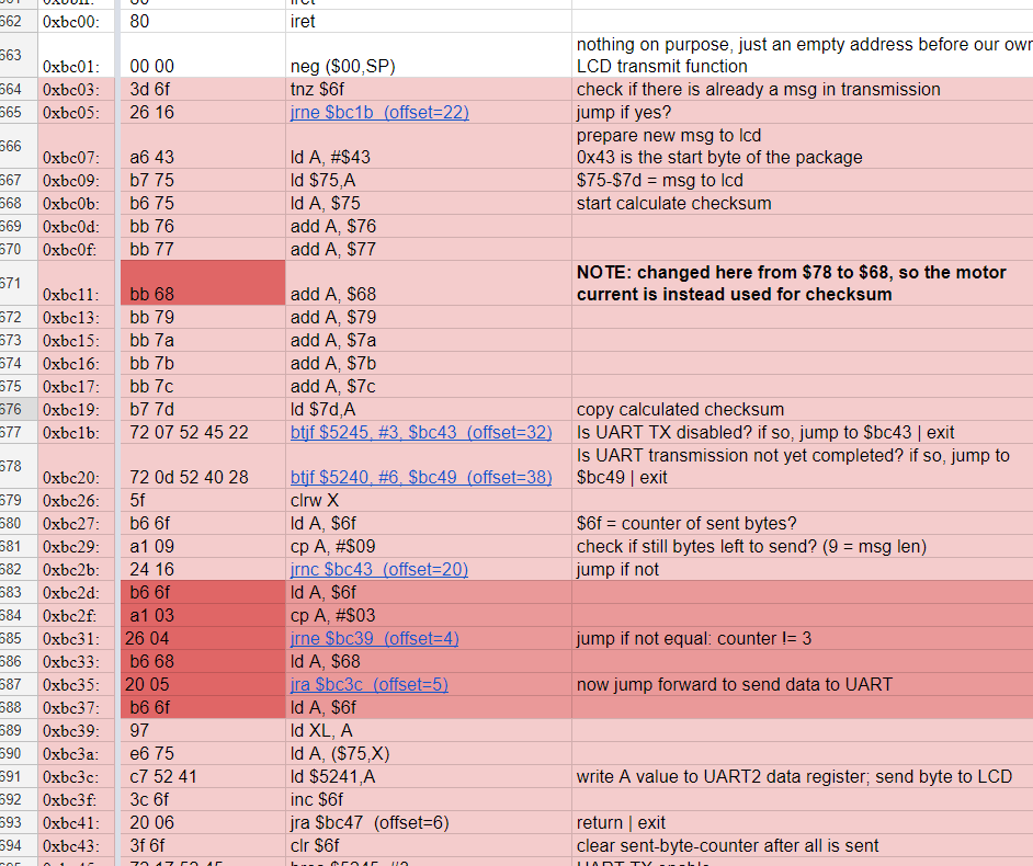

casainho said:
Here is the TSDZ2 original firmware with an improvement to send motor current to LCD (still original LCD does not read motor current). This is mostly for developers/advanced users that may want to use LCD3 instead of the original LCD or some Arduino, etc.
TSDZ2_original_firmware-Flexible.zip
After disassembling we got good insights of some parts of the firmware do work. We could understand how data is sent to LCD and we could add our own function with the needed changes to send the current to the LCD.
Here is current disassembled file with our knowledge: https://docs.google.com/spreadsheets/d/1Zuv3ELZCQJf2eksGHNJ1gKZ7Hxlrk2OHaV0mXiXQ5Hs/edit?usp=sharing
OK, I saw that tables, but as I don't own a TSDZ2 any longer, I've not followed that topic.
