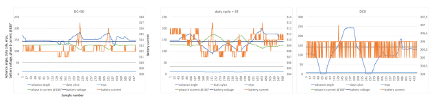

I've done the first test series now.
In hindsight, the result is logical. The lower the duty cycle, the less influence the advance angle has on the phase current shift. The highest regen current you get with duty cycle = 0. I can only test at low powers as my lab power supply only allows 5 amps for the middrive motor that drives the direct drive hub motor.
With lower duty cycles the erps drop a little, as the load increases.
regards
stancecoke

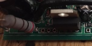

do I choose the lowest current or maximum speed? strongly heated resistor and near fet, is this normal?
Please explain what documentation are you following and which step is asking you that information.
