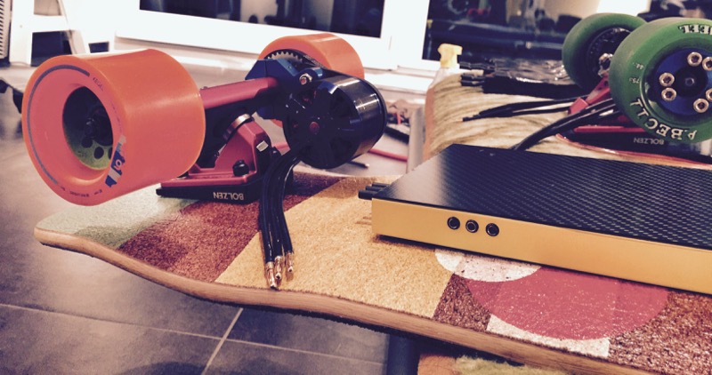

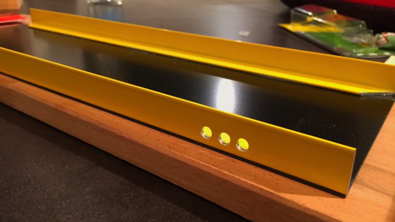

case is all closed up now with 3 holes for charging/turning it on and 3 holes for vesc->motor connection. that adhesive resin is really superstrong. tried to bend it and get those profiles off the carbon plate: no chance! :eek:
clean look of the front. its actually not very easy to be precise with only a stupid hand metal saw. I made all the pieces a little bit larger and then tried to fit them by sanding. it worked quite well, but it was a lot of sanding. :|

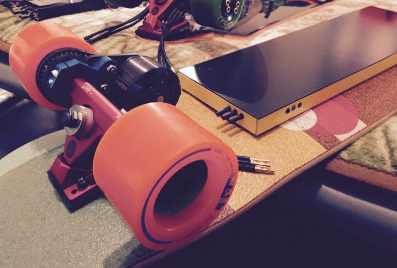

backside, side connectors for charging /on-off already stuck in for a test fit ...
... and now glued in with the same slow resin adhesive I used for the profiles<->carbon connection. currently its curing, put some books on the wires to fixate them. note how I used extra thick shrink tube to make sure that the gold connectors are not coming into contact with the aluminum profiles. the tiny gap between shrink tube and aluminum is now also filled with resin. Ill probably protect my battery with an additional 40-60A fuse to really make sure that nothing ever shorts its.
you can also see that the backside has 3 gold connectors stuck out far outside the case (also glued with resin adhesive) - I couldnt have these nearly 2cm long connectors inside because I needed that room for the vesc. in front of the case you see my red on/off switch *coughcough* :D
finally case on board to get an idea for the weird yellow color choice :D
Ill let the resin cure until tomorrow, then drill the inserts into the tesseract to connect the case with the board, glue in some felt sheets to prevent any rattling of cables and vesc and finally hook up the electronics. then the long wait for spring :cry:

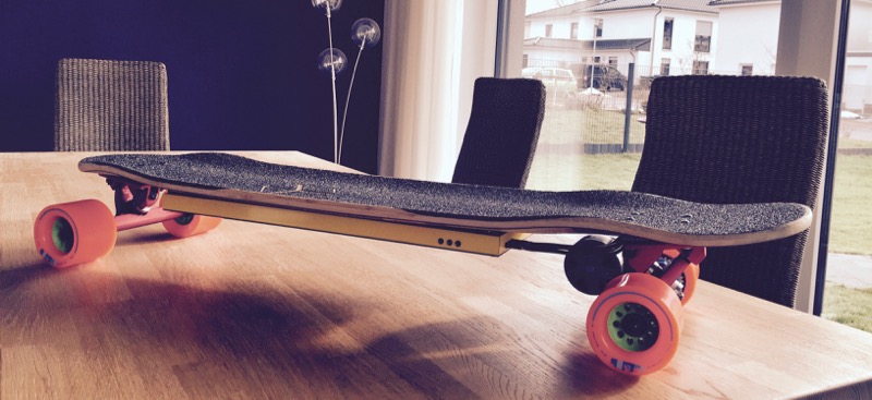

finished my case & attachment to board :)
this time I was very careful with the inserts I drilled into the board - really wanted it to be a snug fit with the case. on my topspeed, attaching the case always comes along with some squeezing and bending of the rubber tubes :lol: - this time I took the drilled case, used double-sided adhesive tape to attach the flipped case on my board (to have baseplate-holes as close to the board as possible), and then drilled a small hole right through the case holes. a major help this time was the double adhesive tape really, so the case was properly fixated on the board.
this time I was also very patient with finding the perfect position on the 3D-molded board. especially the tesseract is an absolute bitch, because the graphics look as if they are aligning perfectly with the middle of the board (& perpendicular to it), but in fact they are off by 2-3°! took the front to rear truck screws as the "real" coordinate system on the board - and Im glad I bought the 60cm aluminum ruler afterall!! ah well, lots of boring stuff for most I guess ... Im always again suprised how easy it is to screw up if you arent patient and careful and lack the right tools. :D
anyway, 6mm drill for the M4 inserts - sank them about 5mm into the board:
attached the M4 rubber rubes (1cm diameter, 2cm height):
and the big moment - attaching the case. a perfect fit, also with the motor cables! /happy
turning it all around and giving it a quick rattle check:
finally checking on the gap between board & case around the board middle (tesseract has quite a lot of rocker as you can see). might be sufficient, Ill have to see in daily business if the case is touching the board or not. if its not enough, Ill add one more rubber washer.
todo: attach felt sheets inside to eliminate possible rattling, organize cables and electronics inside, wait for spring. :)
felt sheet and electronics dealt with, quite a tight package, so attaching case to board with electronics inside is still coming along with some squeezing ... damnit! :p
now the only thing left to do is waiting for spring .. :cry:
