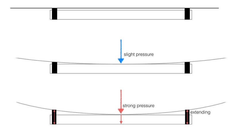

So what happens when board flexes ?,....the middle of board touches and those rubber spacers at the ends Compress to compensate ?? ....suprised there was enough room for them .
when the board flexes, the underside middle region of the board will apply some pressure on the battery (protected by thin felt sheet), the battery will direct that into the case (which is stiff and cannot flex = the battery cannot flex), which then extends the rubber tubes a little to give the board more room.
the rubber tubes extend quite easily, its hardly affecting board flex at all. they come in thicker versions too, like 1.5 x 2cm which are quite a bit harder to extend. alone to protect the battery, its needed that they can extend without much force.
*edit: pic for clarity :D

Nice diagram !,.... that's exactly what i thought. Wonder if the underboard hits the battery first or the Alum Angle's edge ?
...I think i will try your enclosure on my board !
it hits the battery! the aluminum profiles are 2cm high, but starting with a 0.2cm offset (width of the profiles). the battery is ideally only 1.8cm high, but shrink tube & co boosts that easily to 2cm. so in the end the battery is slightly taller than the sides of the case. I dont think its an issues, because the board applies force on the battery on a fairly large surface at the same time and the resistance of the 4 rubber tubes isnt very high. alone the weight of the whole package is extending the rubber tubes probably by 1-2mm. the case isnt dangling, but its also not strongly bound to the board with the 1cm diameter tubes. just the right amount of "loose" imo to dampen vibrations and avoid rattling. my topspeed build has the same case setup and the board is flexing a lot stronger - after about 500km neither the battery, nor the shrink tube showed any signs of stress or wear. :)

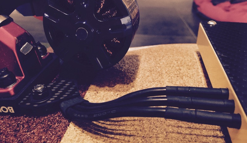

after I nearly screwed up my motor wires by "jumping down a sidewalk -> wires flop down -> get into motor -> ??? -> *explosion*" I just added a small, but pretty good looking detail from leftovers of my topspeed carbon base plate:
its just a little loose, so that the cables can actually move back and forth beneath the carbon plate. to avoid wear, I added a thick shrink tube and I also rounded all edges facing the board by sanding. :D
