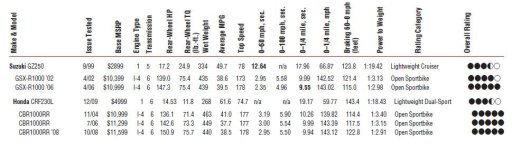

Wow, impressive. My CBR954 would at least be comparable to your GSXR, and I had to fight a wheelie all the way over 100mph even sitting on the tank, so if that guy was riding your bike to its fullest, the bike is STUPID fast!! Nice job!

file.php
