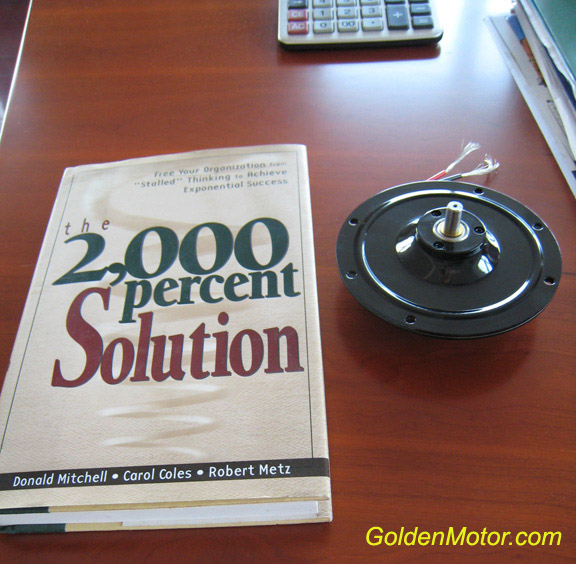

As far as I can tell this hasn't been scooped before, but I stumbled upon these on the GoldenMotor website. They may be of interest to readers of this thread.
They list several versions, the biggest being a 48V 500W version weighing in at only 2kg. Unfortunately they are brushed. They measure approximately 6" Diameter x 1.5" wide.
Dimensional drawings - http://www.goldenmotor.com/PM-double-magnets.pdf
Dyno Chart - http://www.goldenmotor.com/jd-pm-48.pdf
(To visit source page, select the Java embedded "Printed motor" link from the GoldenMotor website's index list http://www.goldenmotor.com/)
so a 4.4 Lb 500 watt motor .... is there a link to where it can be purchased ?
there is this motor ...
Hmmmmm.....
They have a water cooled version too but I havnnt seen anyone testing them yet. Tempted.. might cop stand go brushed for the 10kw + build.
Ps you can always email them for a quote, though I don't know why they can't be purchased directly
