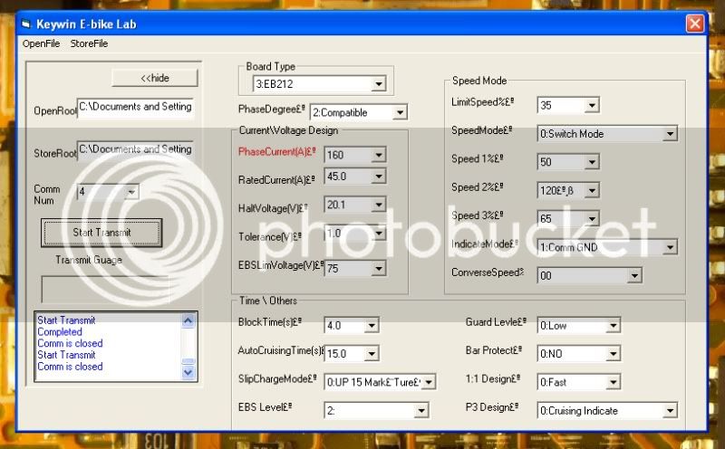

These are my current settings - Ihave my phase current at 2.5x the rated current.
I'll try maxing out the block time...

Bump the block time slowly. Try 5 or 7 first.

I played with the block settings for awhile and I really didn't feel a difference. It's at 10 right now, but I think I'll change it back down to 4 or 5 because that is what I've seen other people using.
I tried to get more power constantly, and I ended up with only 31.51a and 2133w. The bike felt faster then before but it wasn't anything amazing. I did this by raising the max current from 40a to 57a. Both the phase current and rated current are maxed out. If anyone is running a 9c and making over 2500w, please let me know what settings you are running. A screenshot would be great. This is what I have ATM

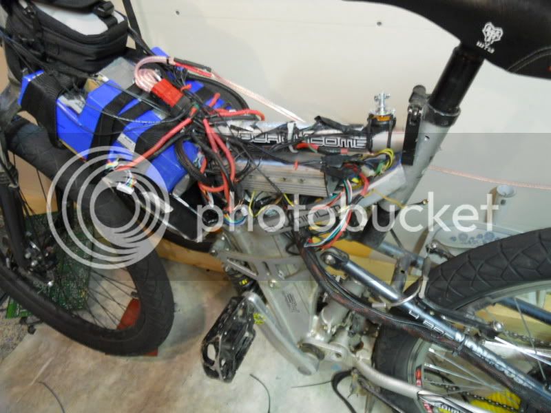

I took some more pictures too
Here is how I have my fan. It's a 12v fan overvolted to about 24v. :)
I couldn't fit the wires through the axle, so I dremeled a small slot in the axle and made the wires come out crystalyte style. 8)
Here's a shot of the other side of the motor. JRH, please explain to me what you mean,, Should I attach cooling fins to my motor?
And I'm open for compliments on my clean wiring! :mrgreen:
One problem I may have is a little rear axle play. When I hit the regen I can feel the axle shift. Maybe I should try to shim my torque arms a little more?

I have tested both the front and rear FH205 and RH205 respectively in 26" and 20" mode running 18S packs on 9 FET IRFB4110 modded controllers with 2x shunts (stock) in place for default 44A current limit, then programmed with EB812 to allow a slightly higher than 35A peak (secondary Limit)...
For my currents I have:
Primary: 40A (actual draw is 83A maximum)
Phase: 55A (actual should be 110A in theory)
Pack Nominal Voltage (18S): 66.6v
Nominal Peak power: 5525w or 7.3704 HP.
This runs fine with stock 9C but I will admit, I don't ride them this way... just wanted to test the limits.
That said, by running 2X or more the Phase Current - you lower your maximum top end speed because Phase Voltage is lowered to create Phase Current Multiplication... understand?
The only benefit to running BT higher, is for low speed or no speed raw accelleration... it should under maximum load enable more current for a very short time... when you have your Phase currents so high already and assuming you could acheive even a 30A boost for 8 seconds (that's the idea) then you would likely toast your phases (even the upgraded ones).
Best bet... set block time to 1, tweak your phase current to be a lower multiple of the primary current (try 1.5x for instance or 1:1 if you want to see true MAXIMUM TOP END)... when you have the top speed you want while you and all your weight are onboard (this means sufficient power to acheive max velocity) then you just bump that to 4 or 8 or whatever, the purpose is to give you less limiting for more low end launchign torque... once your moving it's like a passing burst, that is if your motor is capable of using the additional current.

Well, these are the settings I ended up with. I tried your method Mike, but it was really slow accelerating at 1x and 1.5x phase current. It accelerates very fast at this setting. I pulled a max of 26.43a and I made 1922w. This is respectable, but I still want more. :twisted:
During testing, I looked at my watt meter and it said I pulled 39a and 2750w! :shock: At the same time I noticed that one of the six lipos had come unplugged. It was the pack paralleled with the pack I had my watt meter on. If someone can explain this please go ahead. :?: :?:
And here is a shot of my bike at the top of a hill. This is in a state park. Usually my motor will overheat and I need to slow down and stop. With the cooling holes and fan, I went up the hill faster than I ever have and I never needed to stop. :D

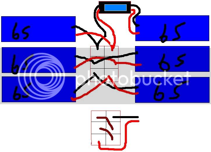

This is how I have my packs set up. I would hook the watt meter up to the entire pack, but I don't think it can handle a fresh 75v, can it?
If the watt meter reads 26a, 1900w,, Does that mean that I am pulling 26a and 3800w throughout the entire pack?
OK yeah taht's not a good way to do it. I have mine set on my Norco to only measure one 6S group and as Mike said it makes your power and voltage inaccurate but most importantly (to me) the current and Ah IS correct (and I multiply wattage and voltage x 3 for true pack values) Mind you that's a 6S2P group - you're only looking at one individual pack the way you have it set up there.
You need to wire it like this:
I have been multiplying the wattage by 3 to get the total power.. Do I need to multiply that by two? Ehh, I'll do a little soldering work and then I'll see what data the lil thing puts out.... Or maybe I'll just wait until I get my CA...
The amperage is off by a factor of two. You will need to monitor the overall pack voltage in a different way, or loosely multiply by three. So you may be running six times the power that you think you are :lol:

Which meter is that? The Turnigy Branded, back lit units work on 18S hot (70v+) but... I smoked a watts up, though I think perhaps it was on 20S and not 18.
To calculate AH used (you do have cell monitoring right?) it would be AmpHours * 3 (as you have it hooked in your diagram) - when connecting the entire 6S subpack part - don't multiply by 3 as you are already getting the right Current now just multiply the voltage * 3 and then the current and voltage together to get true watts..
Based on your diagram, yep your pulling
18S Hot Maximum is 75.6v - I only charge to 4.16/4.18 depending but I've never had issues with the Turnigy Watt Meters at 18S.
Oh and they only ever show 66.4v maximum - maybe time for a CA or another Watt Meter... monitor 12S2P with one and 6S2P with the other... you will get real fast at adding big numbers in your head while riding :)

Actually the way he has it hooked now would probably be ah * 2 although I'm not sure how totally accurate it'd be.
If he wires it like I showed above his Ah will be correct but the voltage and wattage will only correspond to 1 6S bank.
You dont really need to see the whole pack voltage anyway, as you said as long as you have some sort of cell level protection/warning monitoring a single 6S sub pack is fine - the current is accurate, the Ah is accurate and you get used to basing your usage and approximating distance to LVC looking at 6S voltages (assuming you just glance down and don't look for the ah reading )

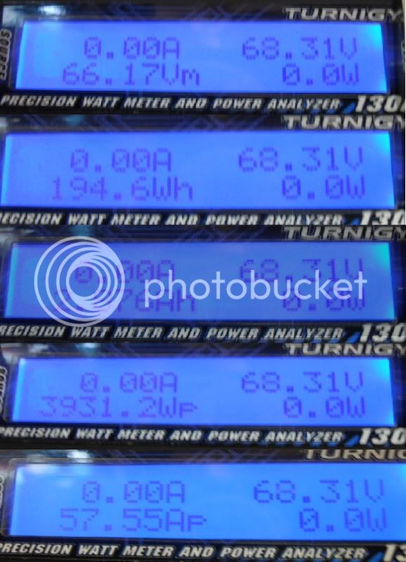

I held my breath and hooked up my turnigy watt meter up to my entier 18s pack....
Then I went for a ride....
:D :D :D :D
When I had my watt meter hooked up to just one pack, the meter read 640.9w. I multiplied it by 3 and got 1922w. I should have multiplied it by 6 and I would have gotten 3884w.
