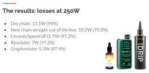

Looking at the tests again..
.. wax, and even drip wax seems to do great in dirty conditions.
..and a mid drive rider is more likely to be riding in this condition, so maybe a high end lube wasn't the best recommendation.
1748725845344-png.370991
Drip wax seems to be a nice middle ground.
