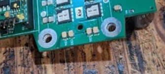

Hello, I think I built the latest version v0.6 and I have a problem with the configuration file. The voltage measurement resistor values have changed to 360k and ~7900k. The mosfets I used were mdp10n027. Capacitors 4x 2000uF 100V nichicon. Everything works on small drone engines, but unfortunately not on larger ones. I set the dead time to 250ns. Is there an updated description of the PCB pins somewhere? Unfortunately, I don't currently have an oscilloscope to check the gates.

250ns is almost certainly about 1/3 of what you need. Normally i run 800ns on the MP2
You'll need to set different parameters for motors. Resistance, inductance and flux linkage. It can be run with all sorts of motors, i haven't found a motor it won't run yet.
You'll need to update the resistor divider in whatever firmware to stand a chance.
I recommend IPA and an old toothbrush to clean the board, it's caked in flux and debris in your pic. This will not help.

I use F405 pill. Both versions 6.02 and 6.05 work. I did the times according to Badginner's docs. Less than 300. Unless I misunderstood and that's not what I was supposed to enter in the MP2.h file. In the meantime, I managed to assemble the second board, which worked magically without any unnecessary problems. Could I have damaged any tracks while soldering the bussbars? The connectors in the attached photo are described somewhere, should I check them myself?

There's a pre made header file for this board for VESC, you don't need to make your own. You are using VESC right? Iirc the dead time is 800ns
The header is for version 0.3, just like the pinout from the image. Version 0.6 has different resistor values and a different pinout connector J1. The new board is available on github with fabrication files.
