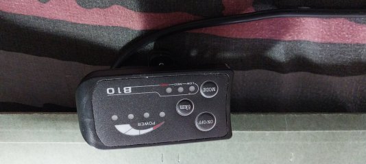

I have an E bike running a Q100 motor with an S-KU65 controller and the usual add ons-throttle and a charge indicat20241210_090219[1].jpgor (pictured) All goes well for about 100 m and the system shuts down-I restart with the on/off charge indicator device and it goes another 100m then stops
I have done the following
Put a load on the battery 2X 24v truck light globes in series and they remain bright for a 10 minute test-lots of heat so i assume the battery is good. The battery is a 36v Li-ion type
Changed the controller to a new spare one same model
Changed the switch device pictured to a spare new one.
Have not substituted a new throttle for the existing one-I assume throttles are pretty robust devices
Can someone suggest what the problem might be??

what voltage is it while you have it under this load?
if it's dropping below the controller lvc under load, then even if it doesn't shut off at the battery the system would still stop working.

Thanks for your answer-I put the battery under the 3 globe load and the voltage stabilised at 34v and held there for a timed 8 minutes. BTW I have been looking for the specs of the KU65 to determine the lvc among other things-where should I look? Thanks
Peter
I am now thinking it is a connection problem-perhaps a joint that heats up and then fails but when cooled it works OK. E-HP suggests using a lower load and that does help-if I creep along on very low throttle the motor continues to provide some drive but if I gun it -it dies
It looks as though the problem is partly fixed-self inflicted on my part.
I was undercharging the battery possibly.
