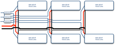

Thanks for the feedback. Is this more accurate?
I know I also need to think about the duplicate pack on the other side of the bike. But I'd like to get the bare bones understood first. But I'm keeping in mind that ultimately the cell balancing wires from the other side will have to terminate in the same HVC/LVC boards of pack 1. If this becomes too complicated I may just bite the bullet and order an extra 3 boards from Methods to overkill, but oversimplify it.

Drawing is improved. You didn't show the output wiring of the HVC/LVC is daisy chained (cable between top and middle, cable between middle and bottom, cable in at top, cable out at bottom).
Bringing all the wires across between the separate packs is not good, would be better to duplicate the whole deal. Then an A/B/both switch to combine the main leads near the controller. Or a circuit board I've been working on. :)

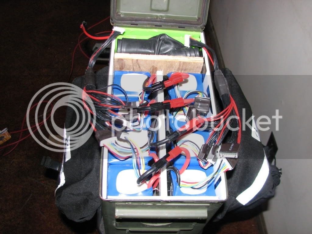

With the help of several E-S members here is my Work in Progress Ammo Box 12S4P 20Ah Pack.
This picture shows the parallel connections of the 6s 5000mAh Turnigys

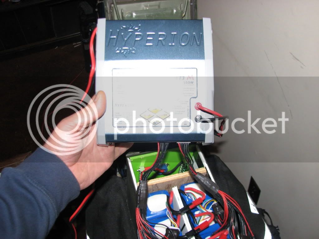

This shows the pack with the mains and the balance cables hooked to the 1420i

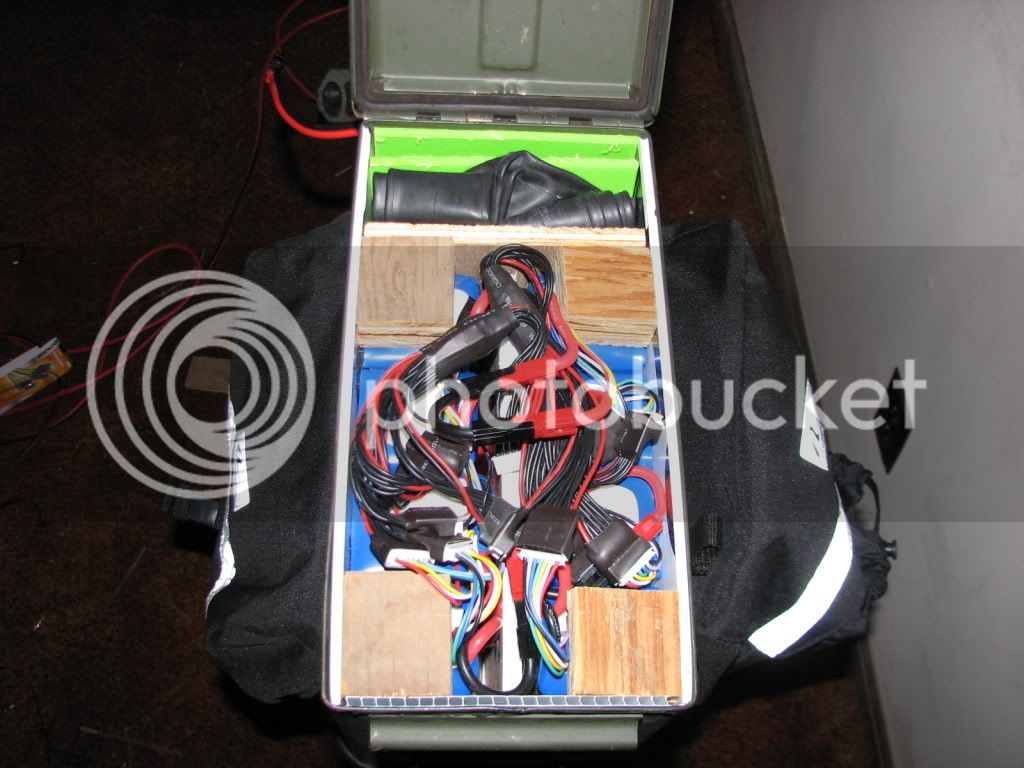

Finally, the pack ready for closing. Not shown is that each side of 4 bricks is taped together. There is a 1 1/2" spacer in the center at the bottom of the box to keep the packs separated. I plan on cleaning up the balance connections by replacing the wood blocks with stripboard running down each side on top of the turnigys. I haven't sourced the stripboards yet as it seems USA suppliers have 2.54mm pitch and the HK-XH's need 2.5mm pitch.
Future plans involve adding GGoodrum's LVC Boards or maybe going to 14S4P by adding 4 2S 5000mAh bricks in the area that now holds my spare tube. This is a hobby and all things are a work in progress. :)

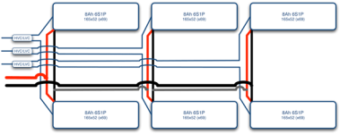

Better?
What do you mean about bringing wires across between separate packs? A/B/both? I'm up for including anything that simplifies things. Thanks for helping me understand.

Improving. Drop the extra third unterminated cable out of the middle HVC/LVC. There are two cable connectors on the HVC/LVC on the non-battery side. They parallel the HVC and the LVC optos. They are both input/output and are just in parallel. On the battery side there are 8 parallel JST connectors, so you can parallel 7 packs and have one connector left over for balance connections to metering or charging.
The board I have is basically a power switch board. It is designed for controlling the main power from the battery to the controller. Two of them can be used for a dual battery setup. I have three of the bare boards in hand but have not put parts on them or tested them. They also have the HVC and LVC connections to the Methods board and handle the throttle and bulk charger HVC cutout. Providing they work as expected they will make a nice installation here. They also handle soft turn-on so no precharge resistor needed. They have four FETs in parallel so good for up to 24 FET controllers.

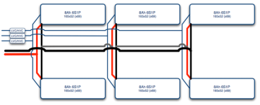

Here's the latest wiring plan.
I'm planning on running 6mm gold bullets between the packs, and 8mm at the leads. I already have beefy 8 and 10 gauge silicon wire as well.
