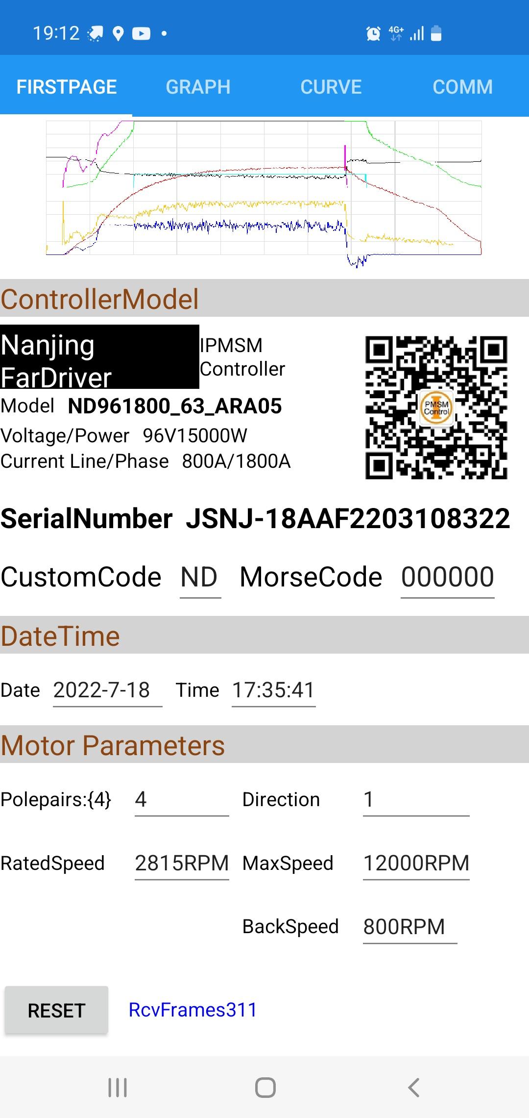

MMD said:So I tried the Fardriver on my ktm where normally the Votol sits. This is the worst controller I every used in my life! The throttle delay is ridiculously dangerous!! When releasing the throttle the rpm keeps rising for about 0.5/1sec until it drops down.
Dui said:MMD said:So I tried the Fardriver on my ktm where normally the Votol sits. This is the worst controller I every used in my life! The throttle delay is ridiculously dangerous!! When releasing the throttle the rpm keeps rising for about 0.5/1sec until it drops down.
I just got a 841800 and experienced the same problem. I happen to know people who work directly with the factory and they told me this is a firmware issue, there's a bug in the firmware. So this has nothing to do with any parameter you've set up, you've basically done nothing wrong, and no version of the app will fix that (well at least none does as of today).
I've been told that the only solution is to send it back to the factory for reprogramming, but I've also been told that they probably won't do it since they don't care about DIYers at all. Great.
The only hope I still have is that the seller (which was not the factory), told me that I can try to flash a different version of the firmware. I hope it won't brick the controller and that this will solve the issue. I will report here after I try, so wish me good luck...
Meanwhile I cannot recommend people to use this product anymore, so I will edit my post in the first page. The product itself is great when it works, but the documentation is horrible, the app is not reliable, the firmware seems buggy in a dangerous way and worst of all we don't get any kind of support by the factory.
It's getting harder and harder to find decent controllers, I don't understand why we should go through these kind of hassles, what a pain.
I have been out again trying to tune the throttle behavior, I havent been very successful..
It is a disaster, the throttle behaves like a rubber band. The softer you set it, the worse the backlash.
The only almost rideable setting I have found is sport, throttle rate 224, ECO Coeff 8. (the most aggressive setting possible)
Then the throttle is super twitchy, you cant really walk with the bike and just hold a little throttle to not have to push.
It will move from off to a little wheel spin on gravel. But when up to some speed it is relatively responsive with not too bad backlash. (Meaning not still pulling very much after throttle release)
The ECO Coeff seems totally useless, anything other than 8 is totally powerless. At least when you are in sport mode (I didnt try in other modes)
I tried ECO throttle also, it is very smooth from a stand still. But then if you twist the throttle a bit more you will have crazy rubberband effect, a big wheelie that keeps rising after throttle release
I tried messing with the "Release throttle" setting again, still I am not sure if it does anything. 7 for sure was not better than 0..
I also tried the speed Ki/Kp settings, not sure if there was any difference.
