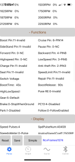

Hey guys hoping someone might be able to point me in the right direction.
I installed my fardriver 96530 and have it working (kind of). For some reason I can’t get the regen to work. I’m guessing I have a setting wrong.
When I connect to the app I can see that my controller is getting the brake signal when I apply the brake (brake control) but the wheel keeps spinning.
Under functions, there's a parameter called "Follow" which you currently have set to 0. Change it to 3-EABSWhenRelease to have it start regen when you release the throttle. There's also an option to start regen when braking (I think it's 2) if you want to be able to coast.
Also bear in mind that there will be no regen if the battery near full charge.
Thanks for the help guys. Got it working.
