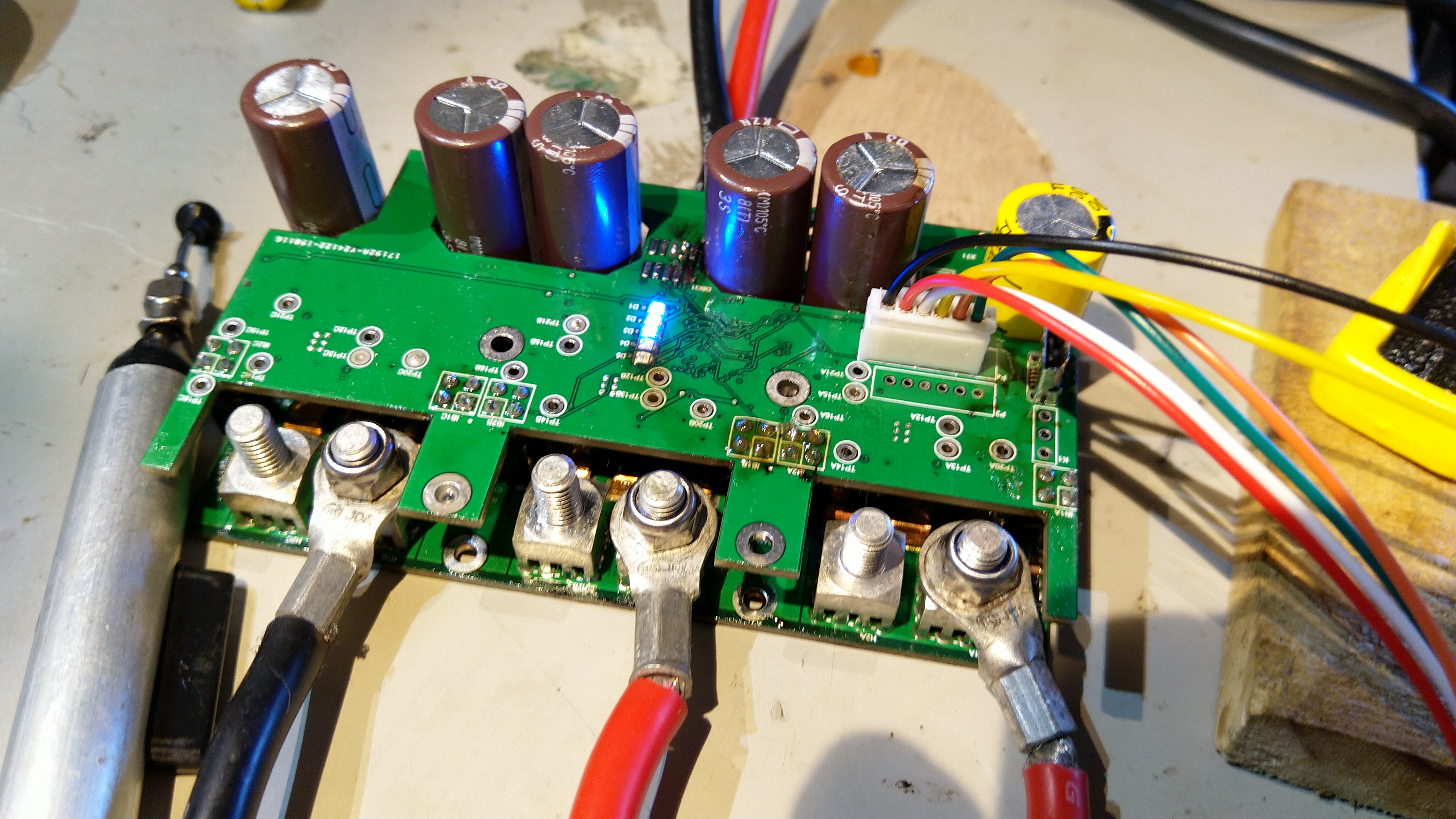

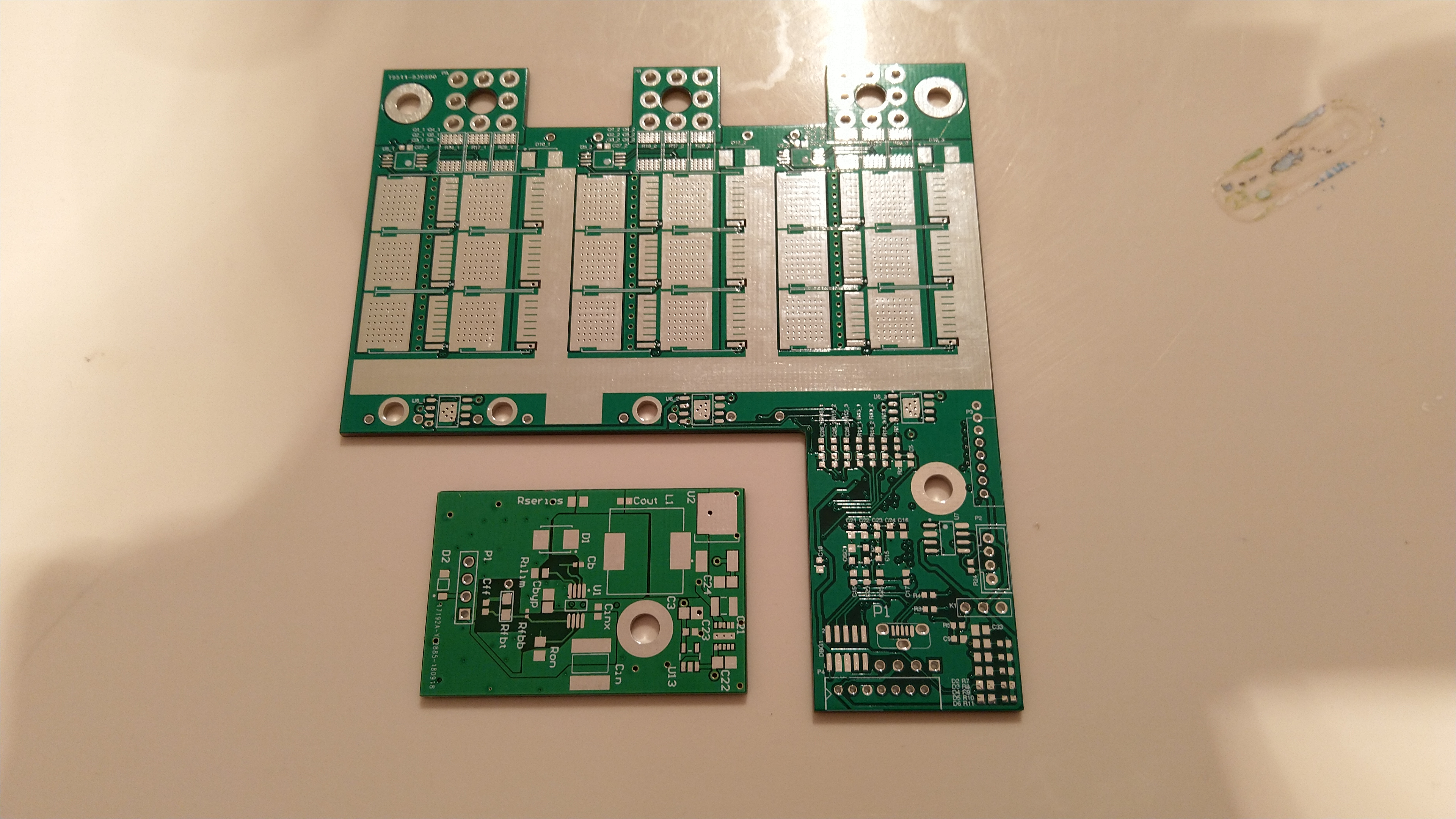

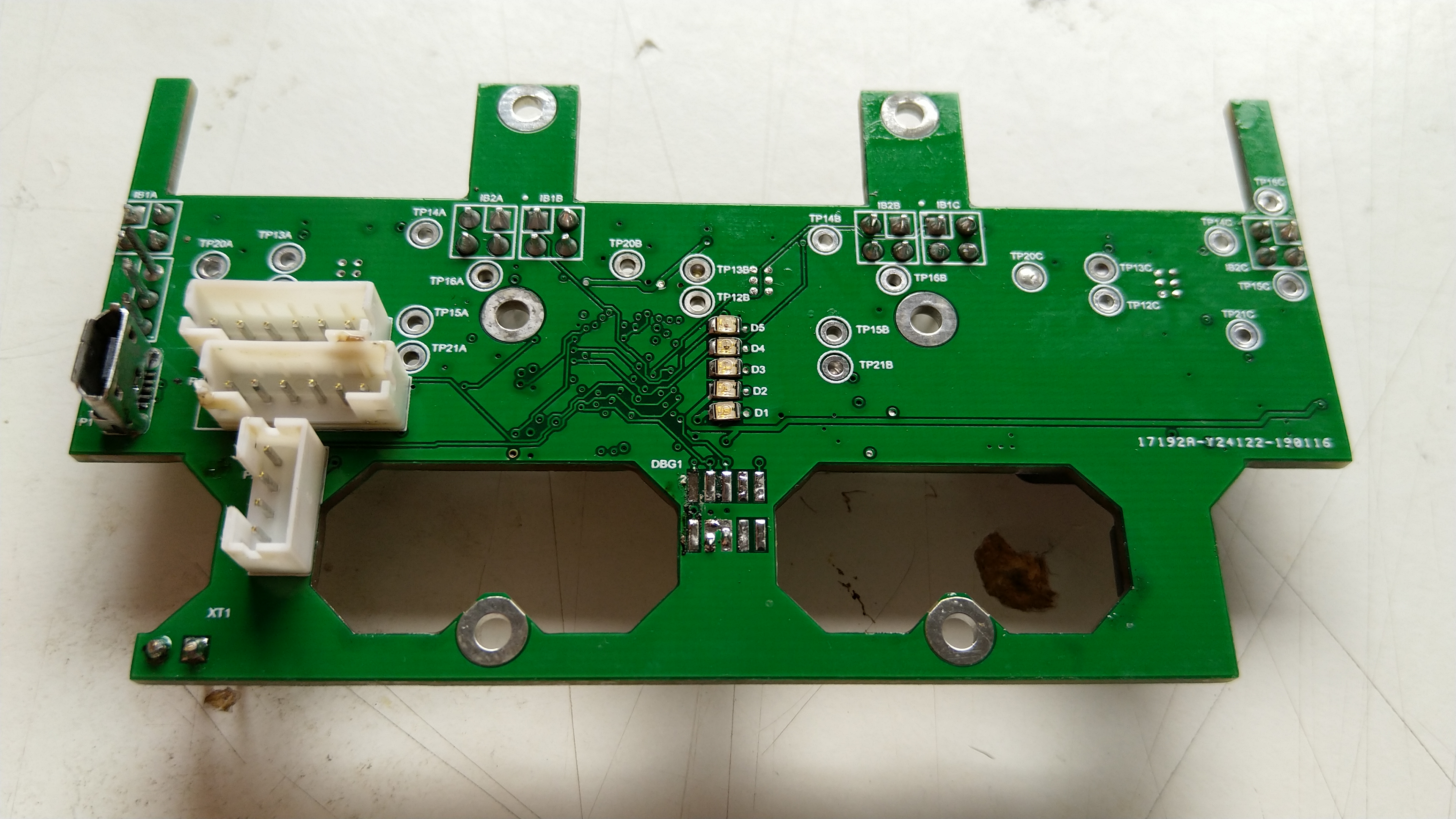

I'm going to start rebuilding the vesc quite soon. Have the pcbs for the new version and am ordering the parts now.
I also realised the encoder has ABI incremental outputs. Since they only need to be used for startup the quadrature signals will only be a few khz before transitioning to sensorless. Latency is still low as they are on interrupts. Much better than the 4mhz or whatever the spi was running at.

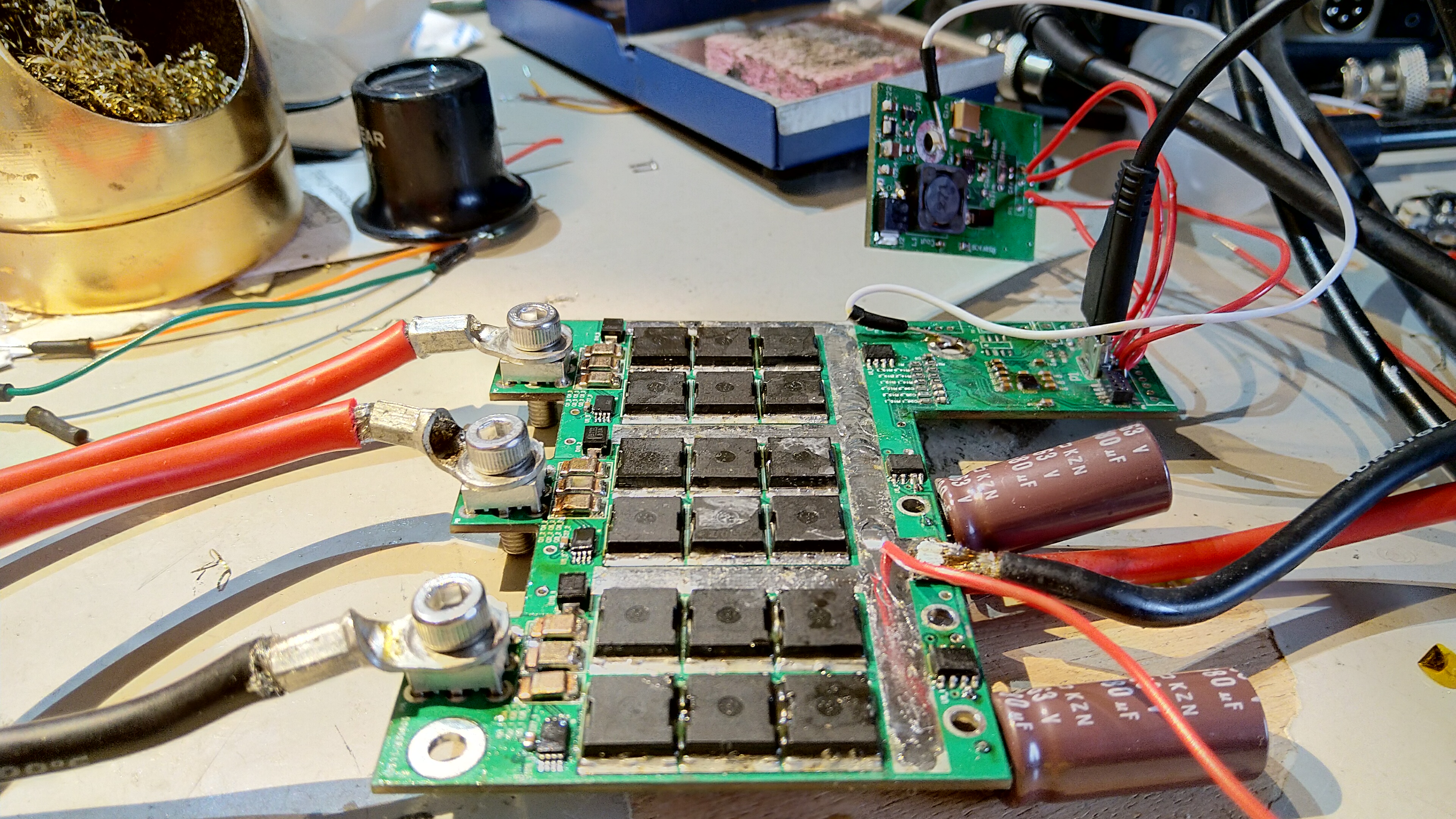

The new vesc is mostly soldered and tests good. Had a hiccup initially where the motor would just twitch with current readings all over the place. Turned out to be one current sensor which had a stuck output. All good after replacement.

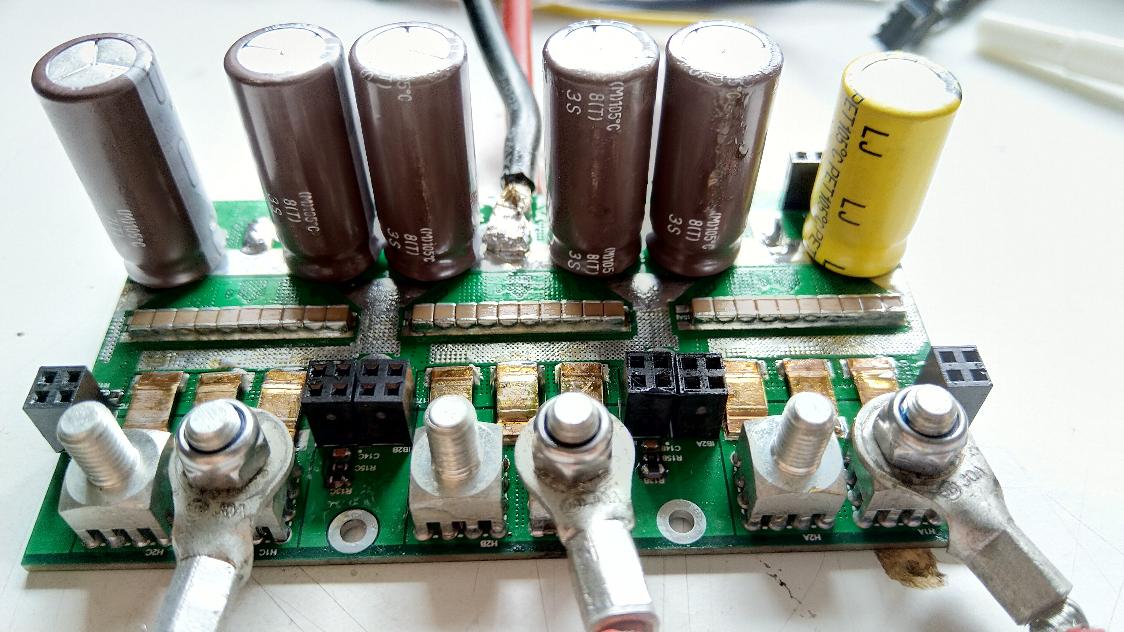

New controller is pretty much done. I've also just finished soldering a much more compact version of the a200s which uses 18 directfets.
Footprint of the directfet version is barely larger than a regular 6 fet controller.
The bus bars and larger fets of the bigger controller should allow for higher peak currents but the compact layout of the directfet controller should allow it to drive all sorts of silly motors reliably.

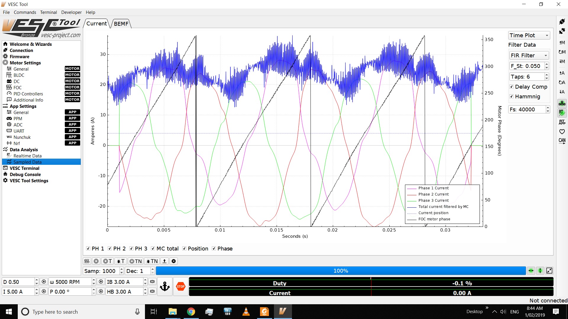

The v1.3 a200s board with the hsof-8 fets has been running well. Played around with the observer gains and rc filters on the current sense output. Now I can be as rough on the throttle as I want at 300A phase in sensorless. Everything is smooth with no faults.
