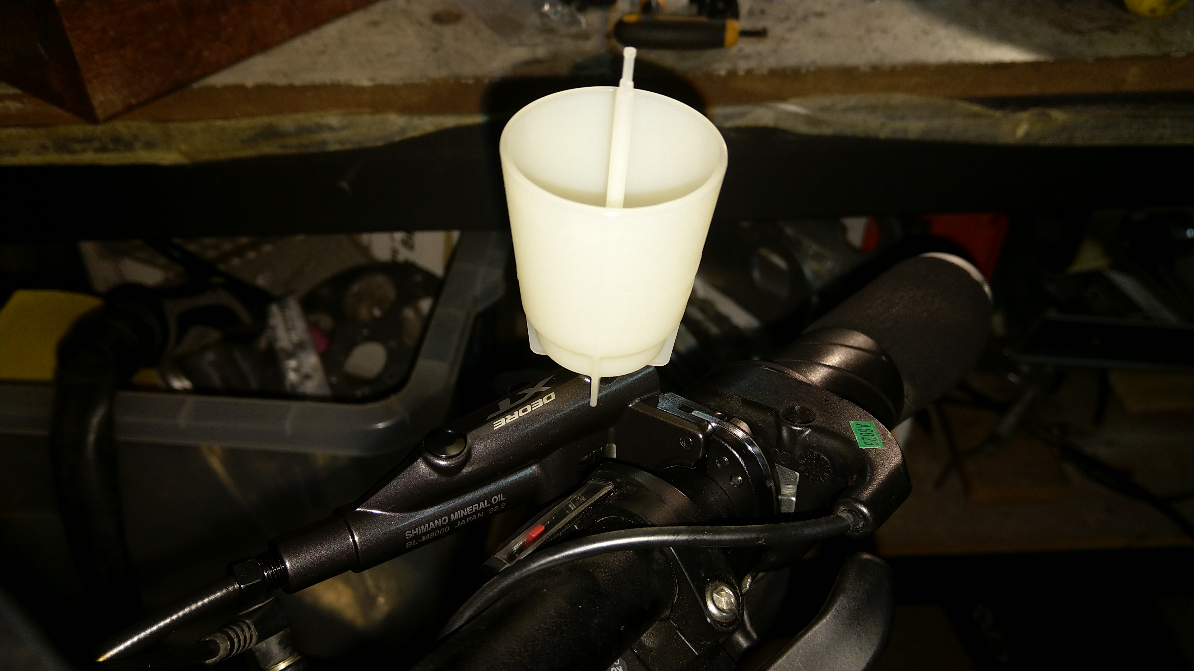

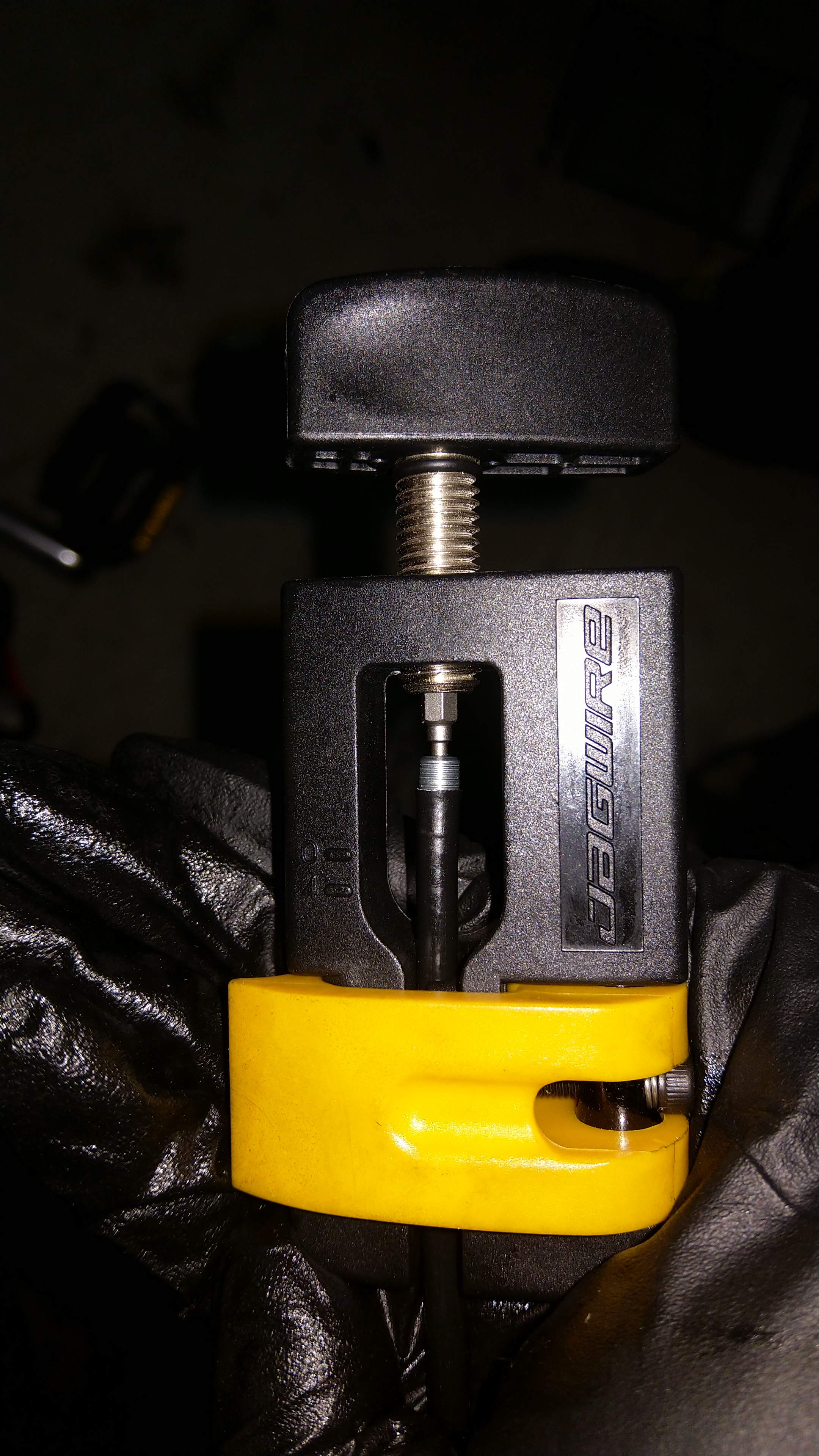

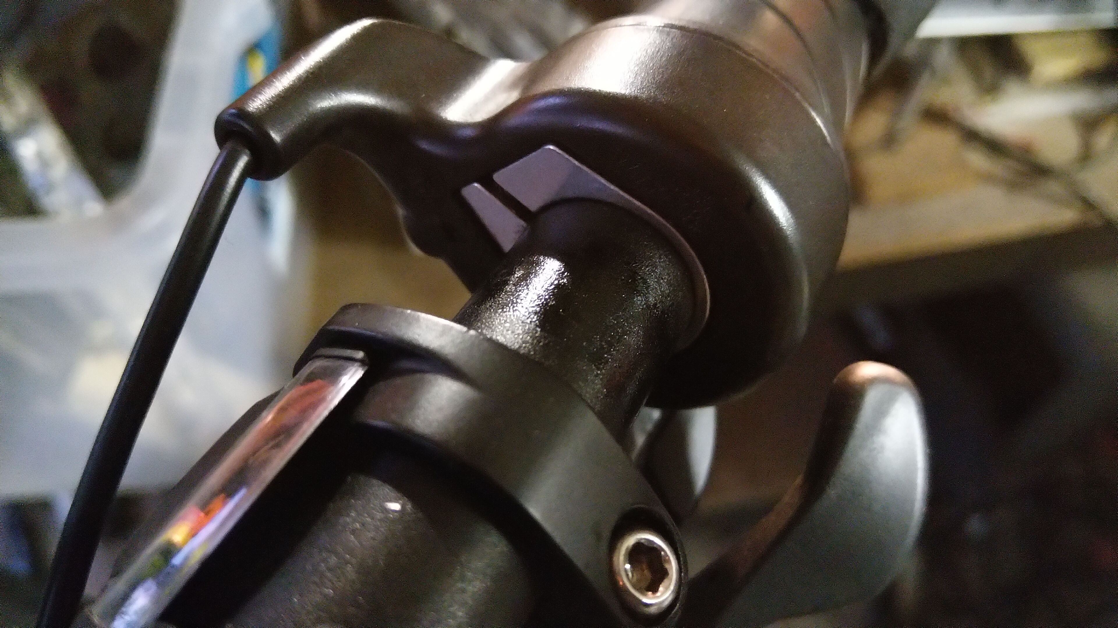

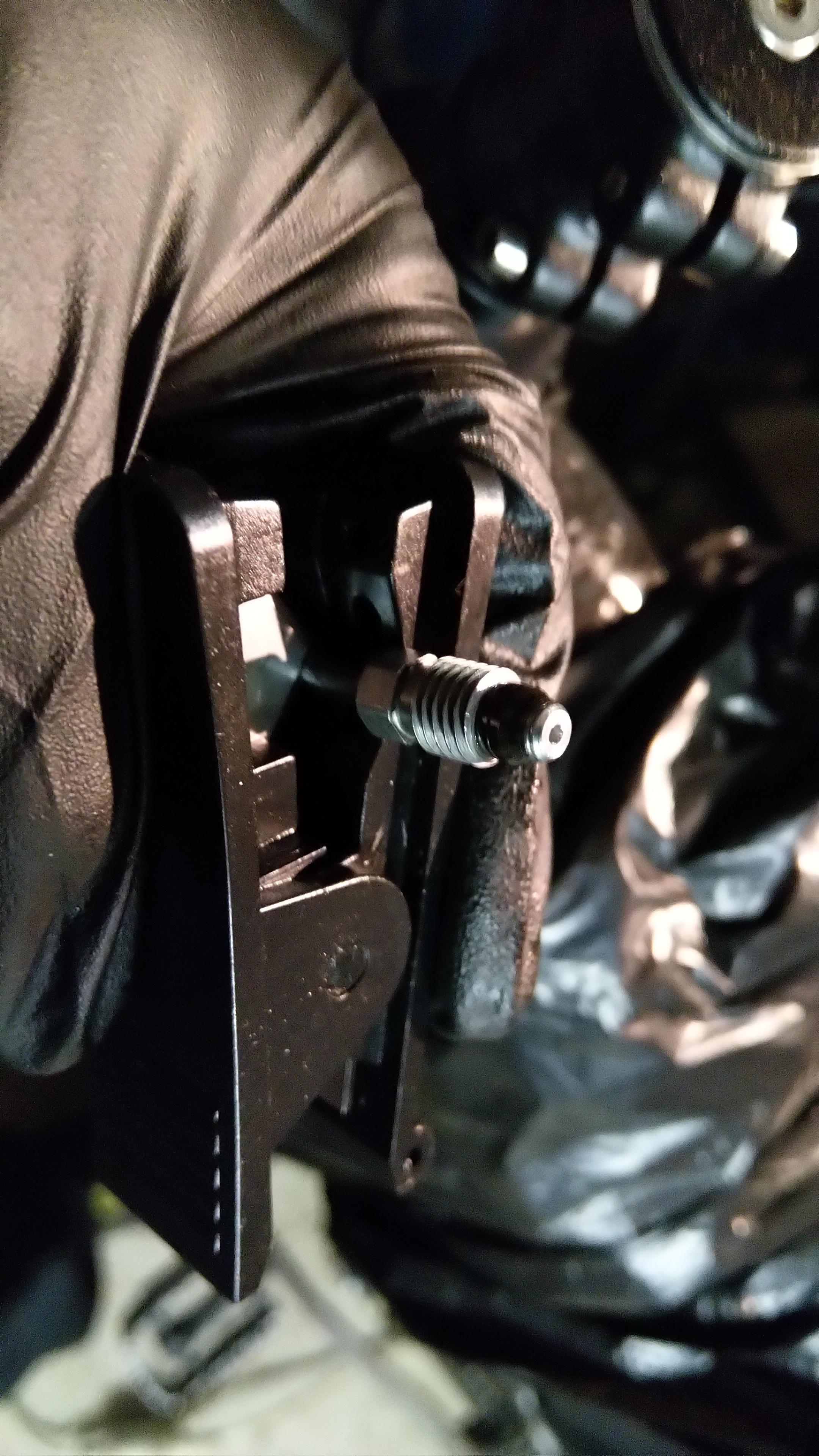

Recently the levers on my mt5 brake was getting spongy and I could see a bit of fluid weeping out of the lever. This seemed crap as I already replaced the plastic lever about 6 months ago for this exact same problem. Calipers were fine and I've found the magura calipers to be one of the most reliable ones on the market. I read on some German forum that shimano levers worked fine with magura calipers so decided to try the "Shigura" mod.
The oil that leaked on to the handlebar and clamp.

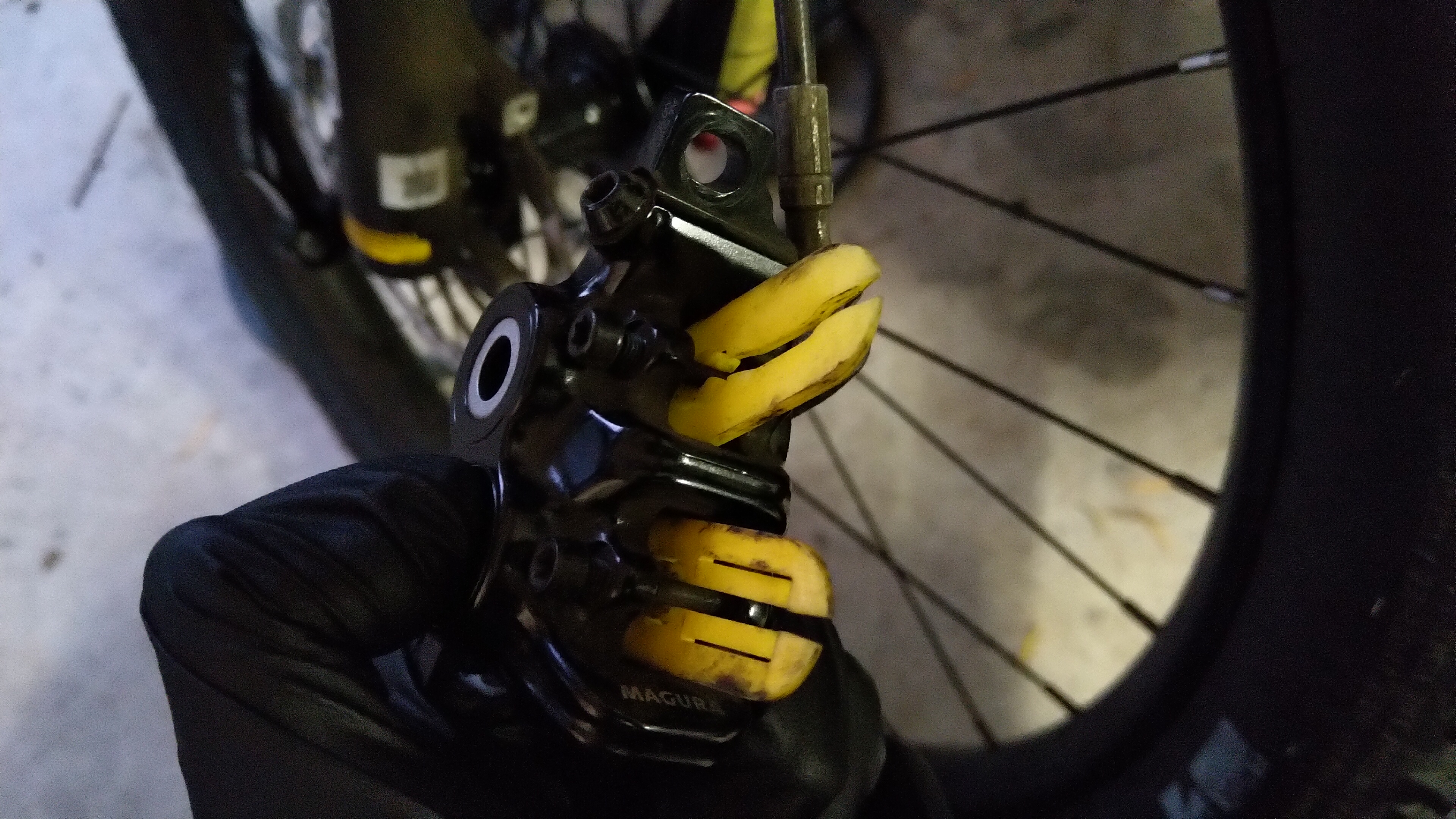

Bleed blocks in the calipers

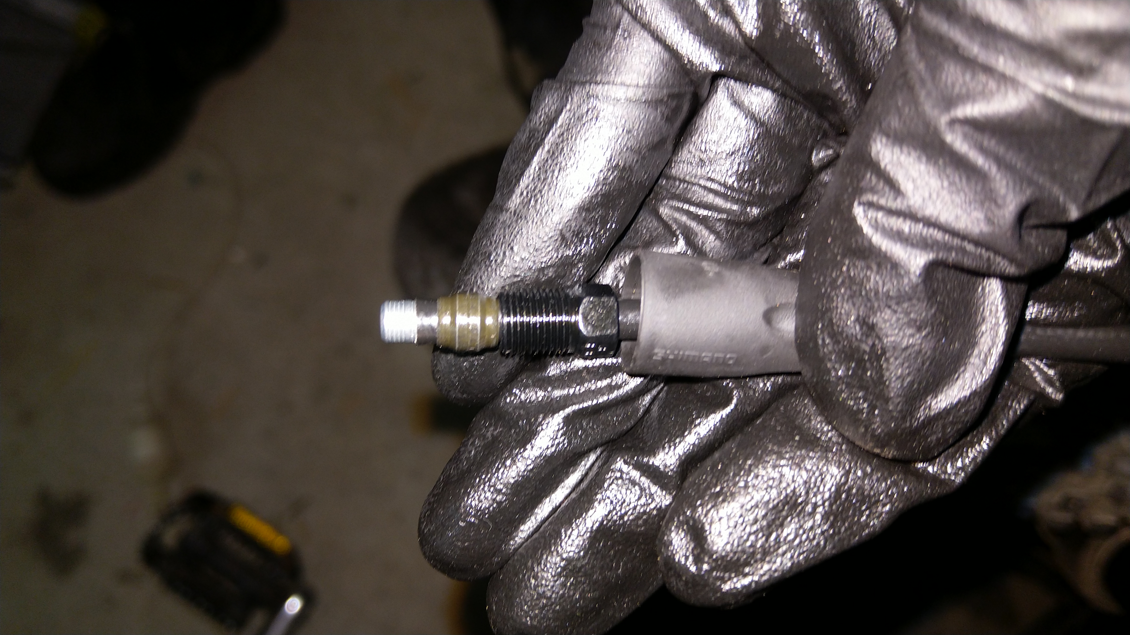

Cut off the old olive and barb
Since the hose is still magura I used the magura olive and barb. The compression nut and rubber boot are the shimano one to fit the lever.
Driving the barb.
Ready to bleed.
It seems to work pretty well! I'm not a huge fan of the shimano servo wave and how abrupt it seems to make the onset of braking power but it beats the leak prone plastic magura levers.

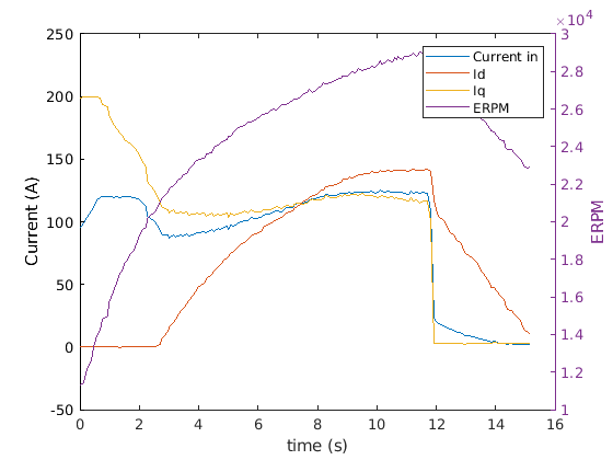

While the hardware on the bike hasn't changed since the my last update, a lot of features have been added to the vesc firmware.
Since the firmware now has separate parameters for the d and q axis inductance, I thought I would try use the Ld and Lq for field weakening.
The Ld, Lq, Iq and winding resistance are used to calculate the base speed where the controller reaches its limit and the commanded Q axis current can't be maintained. The higher the Q axis current, the lower the base speed.
The graph below starts off at my motor current limit of 200A. As speed increases, motor current drops and battery limit kicks in. Unfortunately power drops off a bit before field weakening kicks in.
Iq suddenly drops to zero when I let off the throttle, but the field weakening current is maintained and decays until a safe speed is reached.
The video is on saggy 10s so fw is frequently used and id is capped at 140A.
In the video, the calculations seem to work ok and it kicks in as duty cycle nears max and the controller is running out of steam. That was my first ride on the road and I set it on the aggressive side so I didn't get unintended braking at high speed. If you watch carefully, you can also see that field weakening remains on when I suddenly back off the throttle at high speed to keep the controller safe. It also engages during braking if necessary.

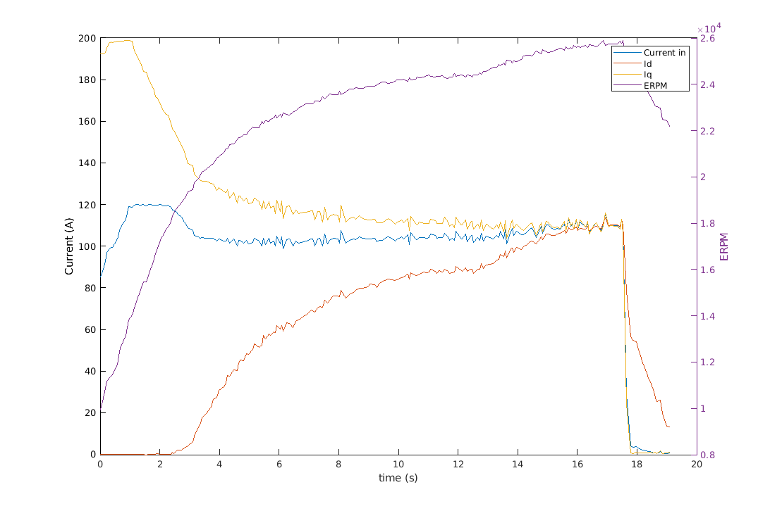

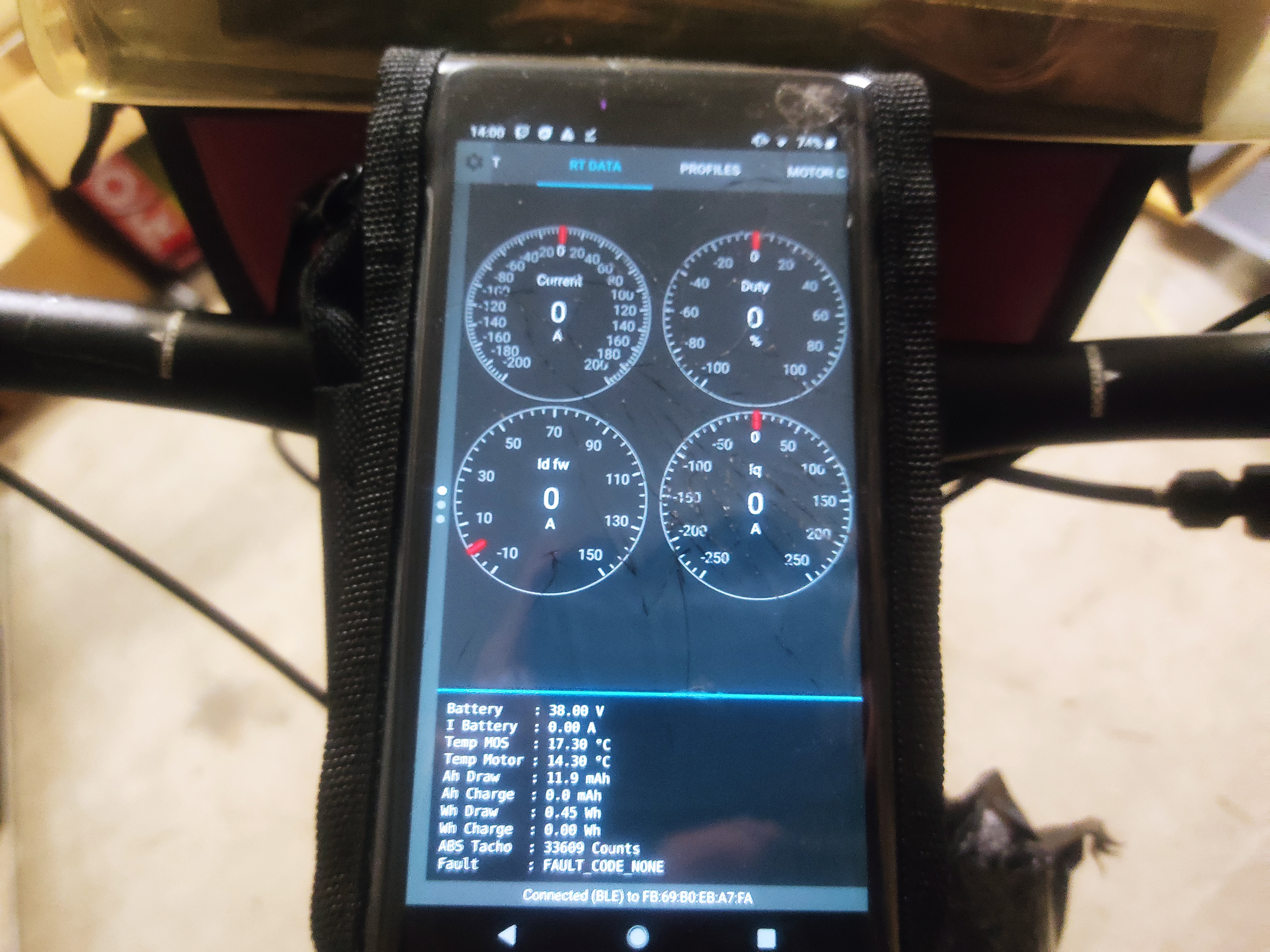

Finally ditched the cycle analyst! For the past few years it has only been a display and I haven't actually used any of its control functions.
Also managed to changed the gauges on one screen to show the D and Q axis currents so I can see what is happening with field weakening.
Tweaked the fw a bit so that Iq decreases smoothly and there isn't that odd surge in power at high speed. Motor power and voltage are now more constant in the field weakening region.
