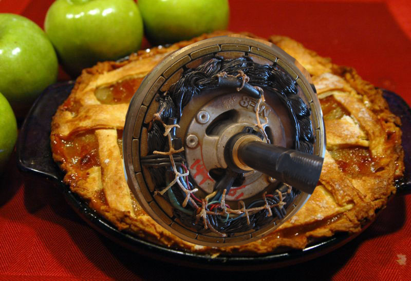

I burnt out 2 SWXH motors running voltages of 16S and 18S. They overheated on hills so be careful. Now when doing long and/or steep climbs I jump off and put my hand on the motor after a hard stretch. If I can't keep my hand on the motor, I let it cool down. I also upgraded my two in use SWXH's to metal gears as one of the overheatings striped the nylon gears. The first overheating baked the coils.

That's great to see Rick. Just keep the Watt limit down with the 10 turn on 18S. 1500W should see it stay alive. Also make sure the controller is equipped with 100V caps and 4110 FETs. If the original setup from Jay was designed for 12S, then it may not be able to handle the voltage. Also you are going to need to be able to program the controller or use CA to setup the current limit correctly.

Interesting. We must be doing something different though as this motor has done about 2000km on 18S and is still going strong. It spend plenty of time between 500W and 800W too.
Just thinking what might make the difference. Firstly I am using the lowest speed wind available 201rpm@36V from memory. My experience is that these low speed motors handle more power than the same high speed motor. I am not sure why this is the case I would love for someone chime in and throw in a bit of theory to explain this.
Secondly, I use a fairly soft ramp on the throttle which tends to protect the gears and one way bearing.
What wind motor were you using when you suffered the failures?

Also 201 rpm wind. The difference might be I was packing myself and a heavy backpack (or light trailer - still 60 lbs). So my weight + bike weight + 60 say. 150+40(older build)+60 = 250lbs. Its not that the 201rpm can handle more power - its more like it provides that power at a lower speed, or provides more torque at a lower speed. This will be most noticeable when first starting out. Combine that and your soft-ramping the throttle probably explains it. I've not had gear wear problems with the metal of course. I just watch for overheating now. I'm going to try the Q100C 328RPM wind next, just for having enough higher=end power to pass road bikes going 50km+ on the flats. The 328RPM should move the whole powerband up. I'll let you know how fast it is on the flats at 14S when I try it. Then an 11-32 XTR cassette and XT cranks that have 26/36/48 cogs means I'll be able to peddle at the higher speeds to. Not quite road gearing, but close.
My Son road a SWXH back and forth to school for about 4 years before the gears broke. That was at 10-12S. 10S at first. 12S when he got older. This is up a biggggg hill everyday though. I calculated the appx kms at 10000+ .
