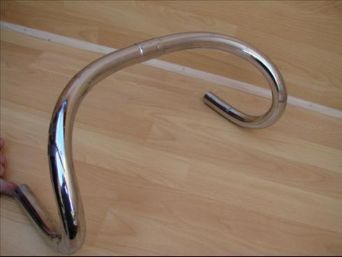

The most common bicycle handlebar bend in the world is called "North Road", after the North Road Cycling Club of London in the 19th and early 20th centuries. Because it's such an old pattern, it has lots of subtle variations among different examples.
These are Clubman bars, used mostly on motorcycles. Like North Road bars, they can be flipped over either way:
These are Maes bars, with round bends and straight sections up next to the stem:
These are Randonneur bars, with a little rise and flare:
And these are Pista bars, which are popular these days for fashion reasons, but which are only really good for grasping at the drops. They are traditionally used on track racing bikes:
These are bullhorn bars, used for time trial and pursuit bikes:
And these are stoker bars (for the rear rider of a tandem), which are similar but wider:
There are lots more, but I'm sure you get the idea.
