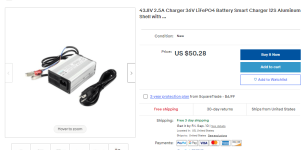

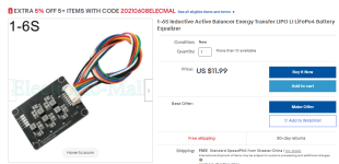

I found a active balancer on e bay that is affordable and am looking for a charger.
https://www.ebay.com/itm/313538382949?hash=item4900580c65:g:i8IAAOSwYl9gqMo-
https://www.ebay.com/itm/254989088778?hash=item3b5e88b80a:g:hmcAAOSwnU1gqeJ8
Please let me know if I got that right and what I missed. Also the active balancers. Will they work in series. The charger I posted is shipped from USA as the cheaper chargers are on that slow boat from China that takes at least a month. The balancers are from China though. Like to get from USA warehouse if possible. The one I posted said it may not be here until October. I am looking for a week or less from USA vender.
Please let me know.
Thanks.
LC. out.

42V ÷ 12s = 3.5V
3.5V = 95% charged
So ... 42V Li-Ion charger should work well with 12s LiFe
No need for balancing with matched LiFe, Standard 3.60-3.65V equalizes retained voltage near 3.40V.
Sounds good. I might try it overnight when they are like around 3.3V but the 42V charger is 1 amp charging 12 cell banks of 5 cells in parallel. Yea. Might do the trick in 12 to 16 hours. For right now it is 5:07 PM and thinking about making a Wall-Mart run in about 3 hours. I am trying balance charge at 8 amps right now. The other LiPo charger is not set up to charge yet as I have to dig for a banana plug. I only got one. I am going to see what the voltage is for each pack after charging for 90 minutes.

Anyway I was hoping for an answer to the question about active balancers in series or parallel.
There is the illustration I did for series but for the power modules it would be a parallel connection.
I know BMSs work in series or parallel so I do not see why active balancers would not work but I am still seeking a straight answer. I was also thinking about using two external 6S balancers while charging 12S in series. LIFE or Lion. Will it work ?
Please let me know.
Thanks.
LC. out.
Straight answer ... unless you have defective cells you do not want an active balancer, even then, you "need" to repair your battery, not "patch" it with a balancer.

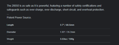

I am also considering more 26650 cells and a 60V - 18S pack with an active balancer and 80 amp fuse. I will be using the same blueprint but instead of three panels of five it will be three panels of six with the active balancer on the end so will need to make it slightly longer for room to mount it.

latecurtis said:
Yea. I am confused.
I guess I will rephrase my question.
Is an active balancer better than a BMS for keeping a pack balanced ?????
A proper built battery should not become unbalanced. No need for any balancing!
You need to measure the internal resistance of all the 18650's you have and go from there.
Either that or charge every single one of them to the same voltage say 3.85V and let them sit for months and months at normal temperature.
You could do a cycle test where you cycle each one and measure voltage, current over time all at the same current and even measure temperature because thats easy to do. You could do up a nice graph and post your handiwork. Charge/Discharge each one.
I think those cheap RC chargers can do that but I don't know how accurate those are.
I've seen other people do it posting graphs, but I dont know what they are using.
Do a search on Endless Sphere, and also check out this website https://lygte-info.dk/review/batteries2012/Samsung%20INR18650-25R%202500mAh%20%28Green%29%20UK.html
and Hobbyking forums https://www.rcgroups.com/hobbyking-441/
A good user name search for ES would be Doctorbass
DrkAngel said:
latecurtis said:
Yea. I am confused.
Well, OK ... If your battery is slightly defective a BMS is "needed", (actually a repair is needed!), if severely defective, a BMS and an active balancer might be wanted.
I did not know it was possible to run both. I thought it was one or the other ???
It is not the LIFEPO4 packs I am concerned with. I think they are ok. It is the 10S - 4P Laudation pack and the two hoverboard packs they were in parallel with. They were not discharging much at all. The bike barley moved. They were all at 42V fully charged but failed. Not sure why. It could be a faulty BMS.
Like I said I have seven 10S -2P hoverboard packs and a 10S - 4P Laudation pack. 180 total cells. 100 that never failed.
The 5+ year old packs - two 10S - 2P SONA and three 10S - 2P Samsung were still charging and running about 5 or 6 months ago.
I just do not know how safe they are. Capacity is somewhere around 50% from when they were new.
I just do not know if I should recycle all of them or keep running the old ones and tear apart the new packs that failed ?????
Please let me know.
Thanks.
LC. out.

It would cost a lot of money to buy all those LIFEPO4s
Also I just calculated the weight of a 60V 19 Ah LIFEPO4 pack.
6S - 5P = 30 cells so 18S = 90 cells @ 100 grams per cell
90 * 100G = 9,000G
