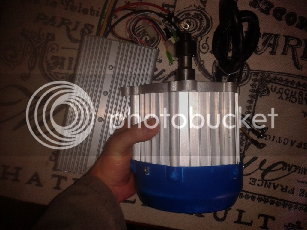

My days of brushed is over. Just got this from china :D Will make a thread later :D

:shock: That motor looks awesome. I can hardly wait for him to post more on it. It looks at least 3 kilowatts. That is a sweet motor. I might end up getting that next. It would fit on the Currie. It looks a little too big for a 20" bike. The diagram I just posted has to be opened up but is probably the last of that type of fork motor mount. I don't see any way of improving it any further. I admit it does stick out like a sore thumb however it will not interfere with the front brakes. Also the rear mount DA posted looks like it would interfere with the rear brakes.
I was actually thinking about installing the MY1020 motor on the back of Magna like that using the Currie rear wheel already set up for pedal assist with the dual hubs. The problem is I would have to unhook the rear brakes and I am not doing that. That is why I want that Izip Metro. The Hub motor is on the back and I can still have pedal gears. Either way the Magna is getting a hub motor period.
I am hoping to get the Dimond Back finished soon like today or tomorrow. Skalabala. Thanks for posting that. You guys are all on my friends list. I will post tomorrow or Friday. I look forwards to more info on that new motor. Thanks again.
