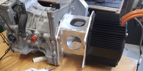

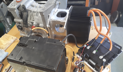

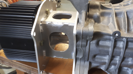

Ok, the dyno is done and motors shafts spin freely.
Now I need your help to control that.

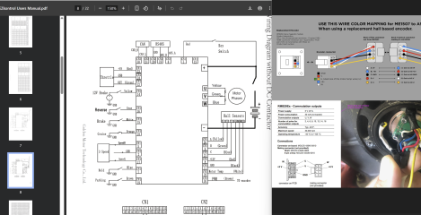

I have ME1507 motor connected to a Golden motor EZkontrol who don't seem to allow sensorless.
Is anyone know how to connect the RMB29 analogue encoder module to the 6 pin of the EZkontrol?
12V on EZ side and 5V on encoder side don't look good to start.

Now I expect some help to have the EZkontrol spinning the ME1507 because it don't seem to work sensorless 🫤

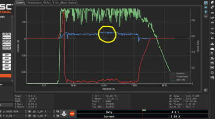

At first I obtain poor results and I have to fine tune FOC current and many other parameters to have higher current from the battery.
Still it's only around 50A somewhere in the yellow circle.
Motor current at 200-250A is also strange, so I bet I have many settings wrong.
With FOC current at 0, the motor spin slower, but need few Amps to spin.
On the graph below, with FOC current set to 250A, it need around 30A just to spin 😕:unsure:
Is it possible that the ME1507 motor with shorted phase wires can not provide enough torque to slow down the Leaf motor?
Seem like RPM stay very high even when the phase wires are shorted.
In fact, with some tuning, I'm now able to start the Leaf motor from 0 RPM with the phase wires shorted on the ME1507.
Still, max batt Amps draw are around 45-50A.

It's clear, battery current is around 40-50A with 2 phases shorted and around 60-70A with 3 phases shorted... motor still spinning way to fast to be at peak torque.
To my, this start to look like the load is to weak.
From what I know, the Leaf can output over 250Nm at 400A and the ME1507 only 120Nm at 600A.
This can explain the situation right?
