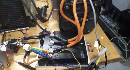

Yes. Especially as I already have the ME1507 connect to a 1500A EZkontrol controller to test everything.
Simply that this controller don't work sensorless and I don't know how to connect the encoder to the controller as I said post #54 Nissan Leaf motor at 60V, 1/6 the power?
I bet if I can connect this encoder to the ME1507, this one will be able to regen at higher current/higher torque.

Ok, a friend way smarter with electronic than me come home and help me connect the ME1507 encoder to the EZkontrol.
Put the power supply to the encoder with 5V and I'm now able to regen strongly and stall the Leaf shaft.

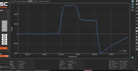

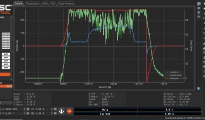

So, the Leaf motor fight the ME1507 motor with 12S battery at 48V, VESC phase amps set at 300A and absolute max current 450A , I started the day with big disappointment.
Only around 3,3 kW (battery) with FW at 0A. Peak rpm at 820 and decreasing at 640 under load.
Then, FW at 300A current max, my expectation was high, but despite peak rpm reaching near 1250 rpm, peak power was roughly the same at 3.3 kW.
To continue...

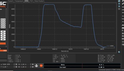

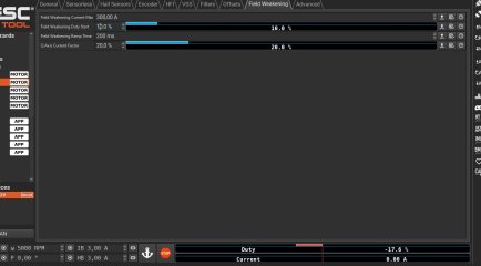

So, I modified some parameters and verify the effects on Leaf motor power or rpm and I find that dropping the Feild weakening duty start to 10% instead of 90% change quit a bit the result.
Peak rpm now at over 1600 and peak power around 7.2 kW at over 800 rpm.
Promising! But now I would like to know why and if there is other parameter to play with to increase power capability of the Leaf motor.
I someone know what I can change to increase power in the advanced page of FOC?

Still, I clearly don't understand how rpm can reach 1760 with light load and drop to 600 underload.
That is because you have reached the phase current limit.
You need phase amps for torque and field weakening.
So at no load and high field weaken you are already using all the available phase amps the controller can provide so there is no more current left for torque.
In order to respond to a load of the motor shaft at higher rpm you need either more battery voltage so it doesn't need so much field weaken or a controller with much more phase amp capacity.

You may be able to get slightly more by turning off field weakening and turning on MTPA. MTPA will also do field weakening depending on it's setting but instead of just applying whatever current you have set to weakening it will, as the name suggests, apply the current to achieve the Maximum Torque Per Amp. Still though you main limit is voltage, exactly as discussed. All that being said there are some issues with running motors continuously with lots of field weakening even if they were designed to do so as the Leaf more probably was.
