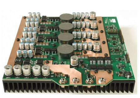

But that wastes power/generates heat and is limited to something like 500mV difference, I think. Meanwhile the DC-DC options built for EVs often convert between, say, 12V to 48V. I saw a 4-channel bidirectional one the other day that could even handle regenerative braking current. 🤤
Hmm, maybe it was based on one of these two:
Both mention charging support (and current balancing by parallel chips sometimes connected by an ISENSE pin). E.g. demo board for the later with two of them working together:
