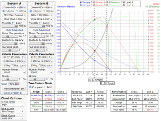

Do you have any hills, even small ones?
If so, the weight/load requirement conflicts with the speed requirement, since torque and speed are trade offs, so in order to get both, you may need to go with a bigger motor.

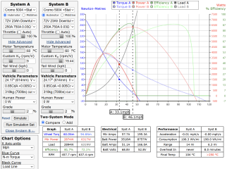

Using the Grin simulator, using wind resistance value of CdA=0.85 (based on google search on model T Ford wind resistance), tire diameter of 24.17" (assuming a 130/70-17 tire), and motor Kv ratings of 9 and 9.44 (high and low Kv windings for the QS273 V4 for comparison, running at 72V:
On flat ground, the faster wind motor achieves 50 mph, but heat could be an issue if riding that speed continuously. The slower wind motor only achieves 36mph and stays very cool.
Adding in a tiny 2% grade, and the fast wind motor cooks itself pretty quickly, while the slow wind motor remains cool as a cucumber.
Both simulations use the Cromotor (big hub), since the QS motor is not modeled, however by using the custom parameters, it should be a reasonable approximation on where the issues may occur.

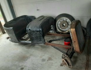

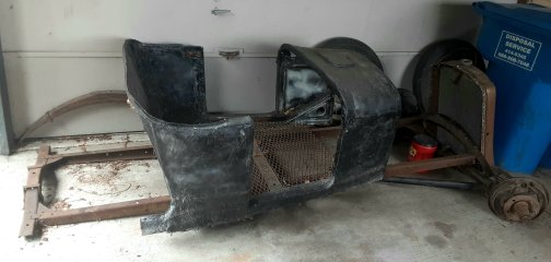

I have a Model T Ford that was turned into a 3 wheeler in the past, a motorcycle swing arm and engine were mounted in the back and between the frame.
Before anything else, we demand pictures. Lots and lots of pictures. ;)
(just kidding...but really....PICTURES! :p )

I have very mild roads around me, though I've one major one to contend with. I live in a town that's on a plateau on top of a hill, so most all my shopping is done here on the flat land. Though to leave town and get back... there's a mile long stretch that is fairly steep. I could always just use my car for that. This is a 3 wheeled Model T after all, no trunk space, my goal is to run to a local store for a bottle of wine or a missing dinner ingredient. My top speed goal of 50mph is hopeful thinking, though I know 40 would probably be adequate. But who doesn't want a tad more power?
When I got it there was steel box beams bolted to the bottom of the frame, mounting the motor and swing arm. A wooden pickup bed that the swing arm shocks bolted onto. He had tried to make an aluminum hood that was also a gas tank, all fiberglassed onto a fiberglass 32 ford grill shell. Last year I stripped away the motor, box beams, bed and gas tank/grill mess, as well as the water pipe roll bar and steering column mount. I picked up a much sturdier Model A front suspension, much easier to lower and add hydraulic brakes to. As well as picking up a mid 20s Oldsmobile grill shell to replace the ruined 32 Ford grill shell.
The easy way would be to add an ATV (thus having a reverse) GY6 scooter motor in back, then just learn to live with that tiny rear wheel. Though I've wanted to build an electric vehicle for ages now and this is a blank canvas.
