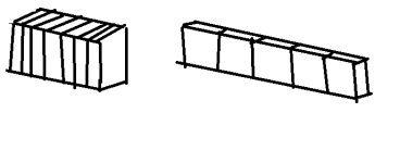

This should allow me have two rows side-by side on the bike
just to be sure, they would be laid out like the first way, not the second? (because they should ahve those large faces in compression)
