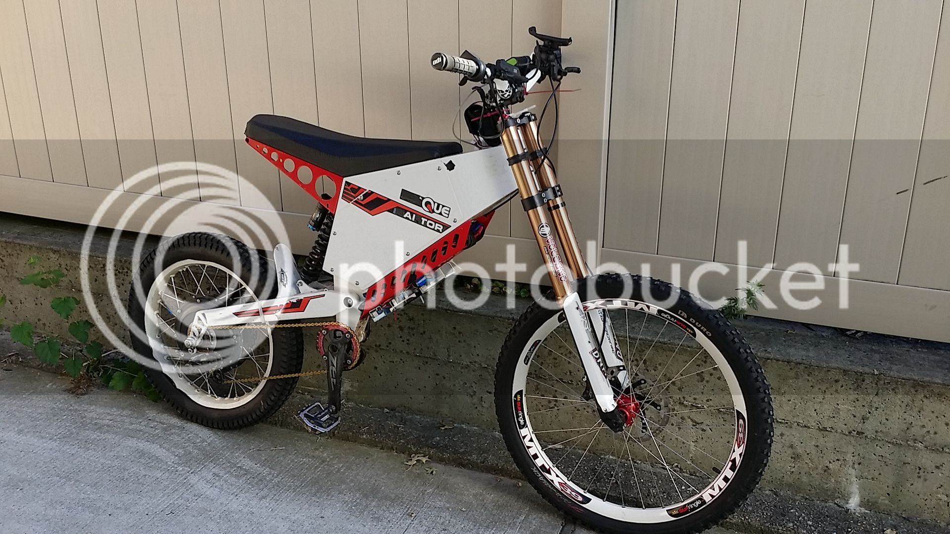

Offroader said:
Here are some pictures of my bike with the DNM gold fork. Best bang for your buck and honestly probably better than my more expensive Marzocchi 888
Electronics for active hub motor cooling. The electronics will also be used to power a front and rear action cam.
These were mounted temporary but I have not bothered to mount them permanent, yet they hold up just fine with off road riding.
Drilled out cromotor for active air cooling, fresh air gets sucked into center holes, goes around the stator and comes out only through the outer holes. Works very well and I can push the motor very hard on hot summer days without overheating. Fan used internally uses like 60 watts at full power. Before this mod my motor would quickly rise to 100c and I had to stop riding because it would take forever to cool off
Variable Regen throttle on left handlebar and regular throttle on right handlebar, this allows for easy breaking without having to always cover the brakes.
I prefer thumb over twist because of more precise control, being able to firmly grip the handlebar at all times.
